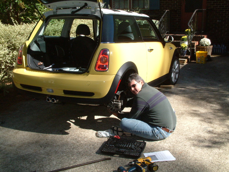

Well... it was a really long day and lots of accomplishments, but not without it's woes.
A 13 hour day yielded the following accomplishments...
2 pulleys - pir8 97, agile_moments
3 rear sway bars - LeeL, pwjcw, mini03tiger84
2 short shifters - agile_moments, pwjcw
1 set for front rotors and pads - pir8 97
1 magna flow exhaust - agile_moments
1 oil change - mini03tiger84
1 trip to Autozone 0 a long story there... but don't a belt for a MCS w/o check the length
1 trip to Ace for bolts
Did not do...
hmmm I think we got it all

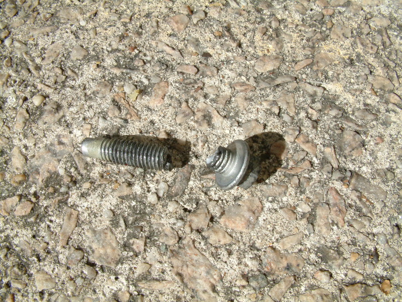

LeeL sheared a shock tower bolt trying to torque to BMW spec of 100Nm... I think 75 is much more reasonable. A couple hour setback there after drilling and using easy out to extract the bolt.
Agile_moment's exhaust install needed a few trys to adjust the brackets to get the tips hanging at the right height. (and apparently it needs a lot of grease )
The short shifter installs... well the '04 shifter box is a pain in the butt. It took longer to install the short shifter than the Keith and BJ installing the sway bar on the the same car.
Anyway, it was a great day, beautful weather and lots of Mini-ing.

A little mix up. Agile Moments did not do a rear sway, I did, I'll never forget that feeling when the shock tower bolt goes pop!
