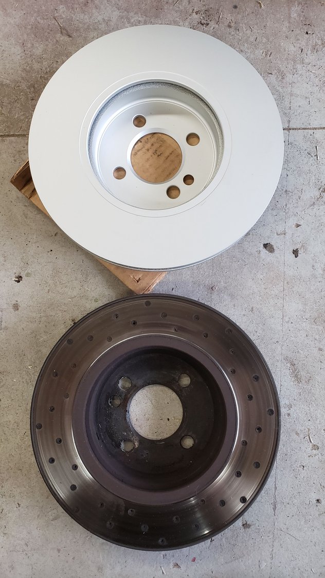

I made some more progress on it today. I got the drivers side done. I'll do the passenger side tomorrow and flush/bleed the system. Got chased out of the shop by Mosquitos. High temps are only supposed to be in the 40s tomorrow so hopefully the little flying blood suckers will not be out.
If anyone is wondering, 15" Knonig Helium will clear the R56/JCW front brakes but weight placement is critical. I got lucky on the drivers side. Hopefully I'll have the same luck on the passenger side.

What I started with.
276mm vs 294mm.
276mm vs 294mm.

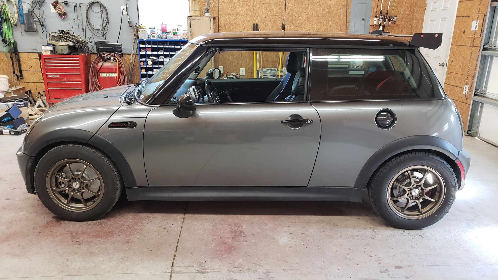

I finally got this thing off the jack stands this morning. I have a couple thoughts on the SoloWerks. First, the lock collars and spanners are thin which can make adjustments difficult. Second, they are low. Like very low. I cranked the front up pretty high and it's still sitting only about 1/4" above what the instructions say is minimum ride height. The rear seems to have a lot more adjustment but the front almost seems like it needs a longer or stiffer spring. It was a busy day and I didn't get a chance to drive it so I have no idea if the ride is even any better than the Racelands.
I'll post some pics and report back later on the week after I put some miles on it.
This is with the collars a little less than half way up the shock body.
Here's how it sits now. Collars are probably 3/4 or better up the shock body.  Cranking it up like that is preloading the spring and removing travel at the same time. Idk. I guess I'll see how it drives.
