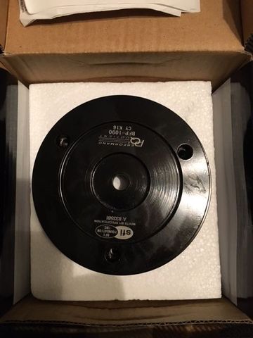

I have the new dampener:
Now it is about the time I will have to get it in, as I am super busy with our Mini sales right now, which is taking up my shop time.
Thanks Mini Mania! See you in June 2017!

This is what it looked like:
It was not rattling around, so I had ruled it out.
The OEM ones are just crap!
