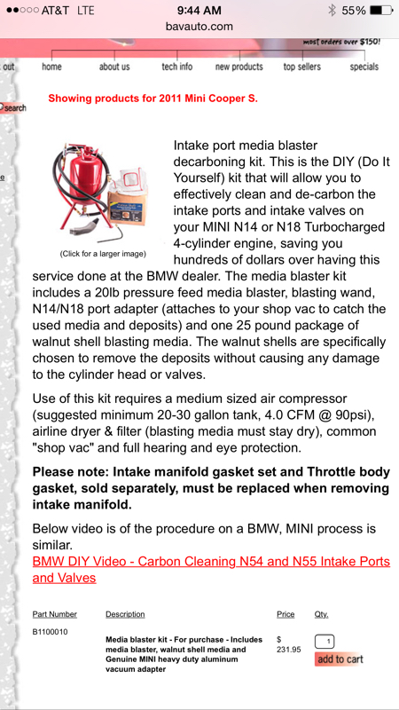

Has anyone seen, used or bought the Bavarian Auto's media blaster kit? $231 It appears to be a decent deal. Comes with everything except the air compressor, in-line dryer/filter and shop vac. Carbon build-up problem..............-image-196846582.jpg

If you want to carbon blast DIY here with the tools linked:
https://www.northamericanmotoring.co...-cleaning.html

If you want to carbon blast DIY here with the tools linked: https://www.northamericanmotoring.co...-cleaning.html
Thanks. Read this entire thread a few days back and just wanted to know if anyone bought the Bavarian kit specifically. I don't want to fab a kit myself and want everything to work correctly and want feedback as to if its undersized etc. By the way....ECS....just received my shipment from you guys. Thanks. Haha.
You are welcome. Ok, did not know ,you knew about the DIY thread.
