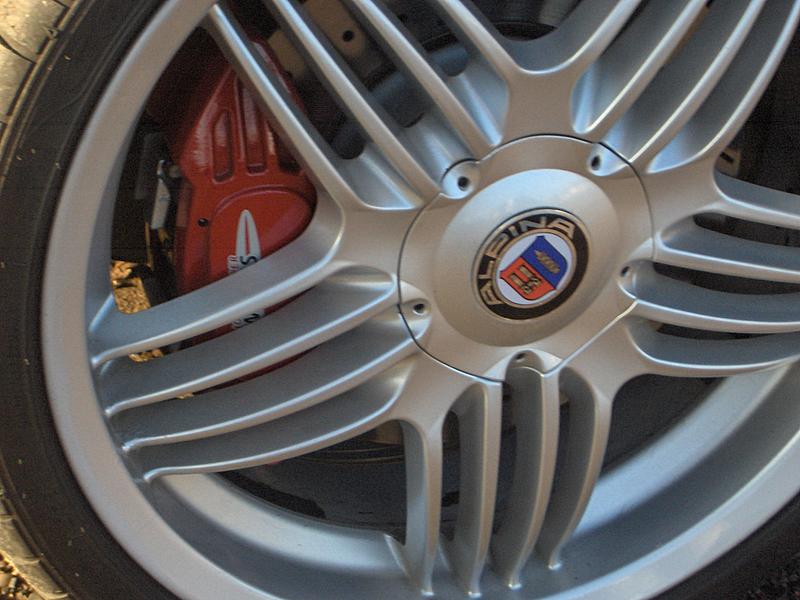

heres mine bbk on 06 with alpinas
Attached Thumbnails Spotted: R53 w/JCW BBK-hpim2545.jpg
