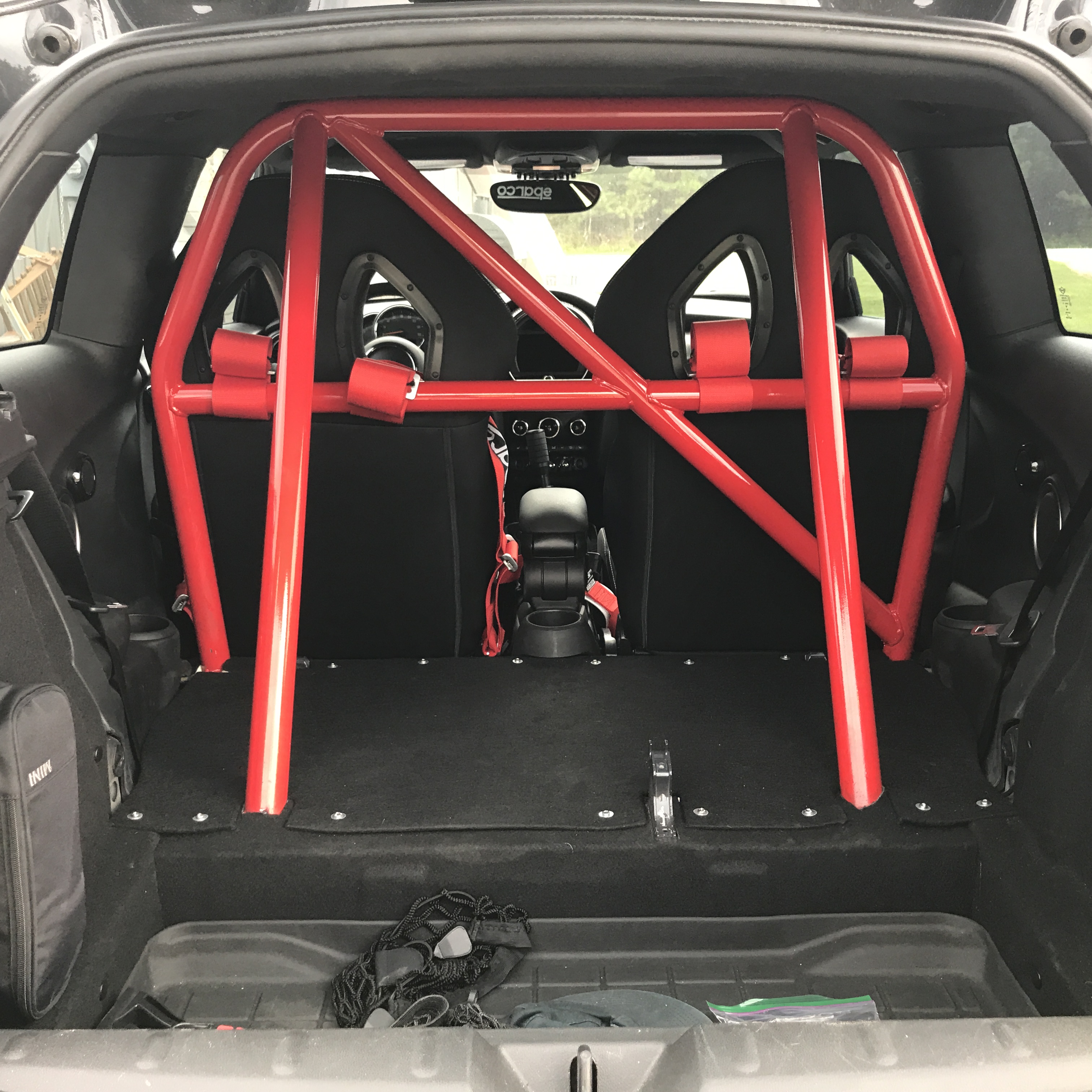

This is the prototype bar that Sneed4Speed made for the F56. It's a 4 point bar w/harness bar. It's NASA and SCCA legal. I retained the stock belt for driving around town.

Old Feb 6, 2018 | 12:05 AM
laddken's Avatar
laddken
Joined: Feb 2018
Posts: 12
it looks really good, they do some great work on there products.
