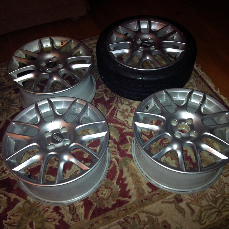

Here are some pictures of the test fit..

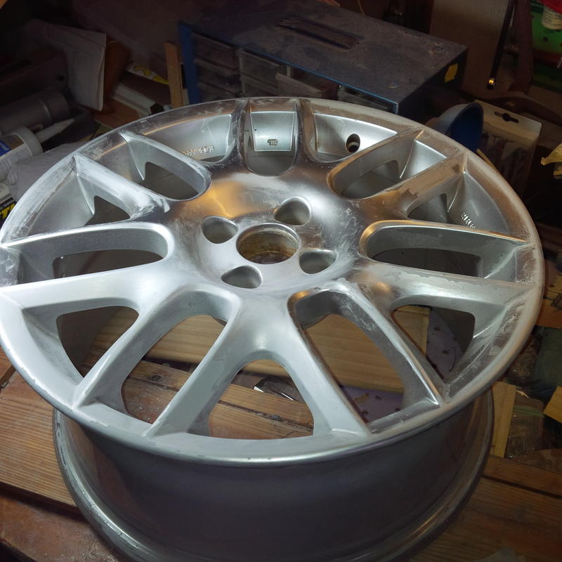

Old Apr 22, 2014 | 10:56 AM
DOtheDEW's Avatar
DOtheDEW
Posts: 361
From: Boston, MA
one of the wheels had some curb rash(the one with the tire) and another one was in a fire, the rest just had some rock chips, i started to sand down the fire wheel first to see how it looked.

Old Apr 22, 2014 | 11:09 AM
DOtheDEW's Avatar
DOtheDEW
Posts: 361
From: Boston, MA
there were a lot of imperfections in the wheels from rock chips and so on, so i filled the imperfections with jb weld and sanded them down after, the third attachment is the curb rashed wheel after it has been filled and sanded down.

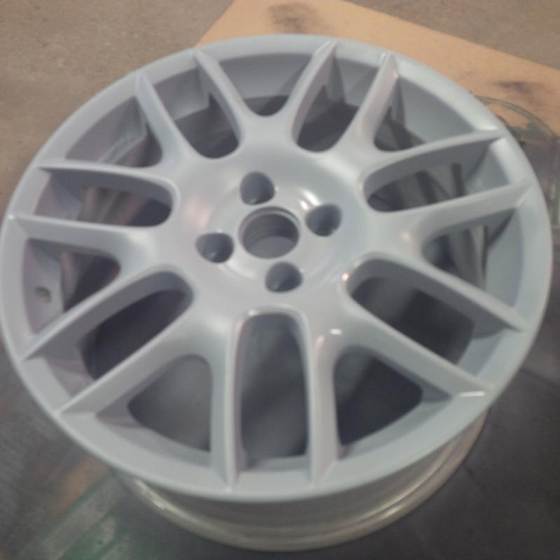

Old Apr 22, 2014 | 11:25 AM
DOtheDEW's Avatar
DOtheDEW
Posts: 361
From: Boston, MA
the next wheel i primed was the curb rashed wheel.

Old Apr 22, 2014 | 11:31 AM
DOtheDEW's Avatar
DOtheDEW
Posts: 361
From: Boston, MA

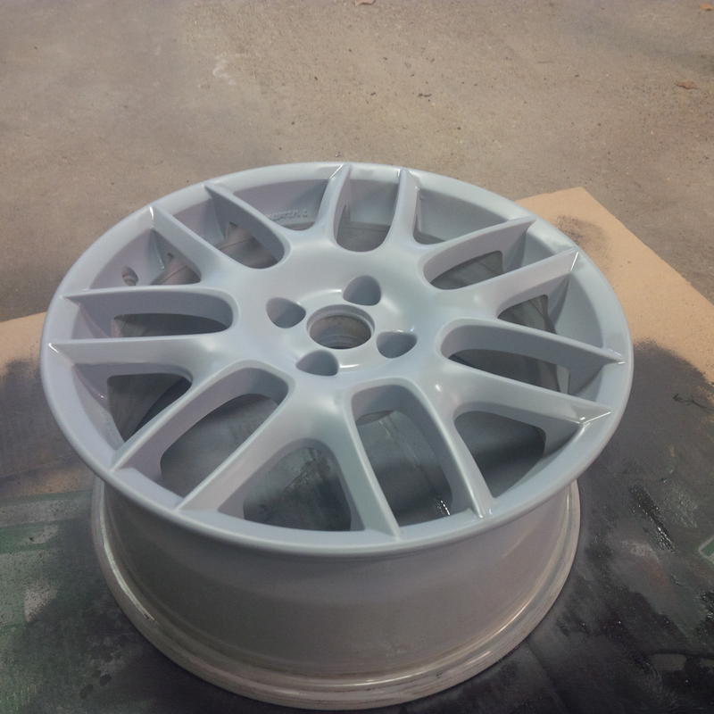

i did three coats of primer inside and out of the wheels, it took me three cans of the primer to cover everything. then i dry sanded the outsides of each wheel with 600grit dry/wet sandpaper to get a smooth finish.

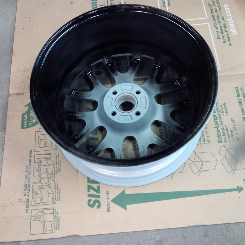

Old Apr 22, 2014 | 11:39 AM
DOtheDEW's Avatar
DOtheDEW
Posts: 361
From: Boston, MA

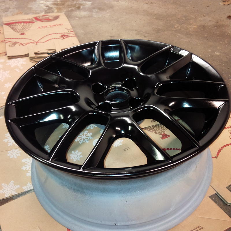

next was to do the second and third coat. wait about 10 min between coats. (on the first two wheels i forgot that you could see that spot i didn't paint when the wheel was on so i had to go back and paint that after) when the insides of the wheels were dry i then painted the face of the wheel, again very light coats and wait at least 10 minutes between coats.

then do the second and third coats, this wheel is the curb rashed wheel

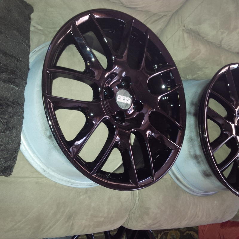

Old Apr 22, 2014 | 11:46 AM
DOtheDEW's Avatar
DOtheDEW
Posts: 361
From: Boston, MA

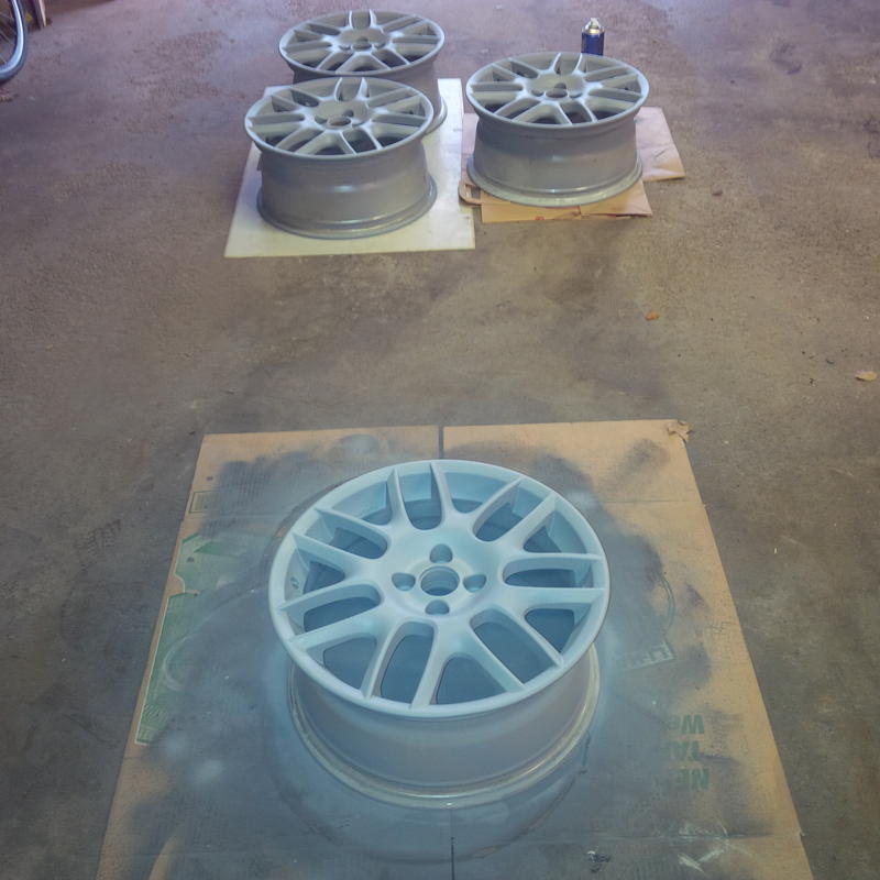

the first picture is the fire wheel and the curb rashed wheel, after all four were painted with three coats, i then painted the clear coat. the stuff i used was that spray can in the picture, you shake the can for 2 min then take the red thing off the top of the can and put it under the can where there is some sort of button, you push down the button with the red thing from the top and that inserts a gel into the can, you then shake the can for 2 more min and then you good to paint the clear coat. after you push the button on the can you only had 48 hours to use the can so time it all wisely, i did the clear coat all in one day.

Old Apr 22, 2014 | 11:49 AM
DOtheDEW's Avatar
DOtheDEW
Posts: 361
From: Boston, MA
with the clear coat also start on the inside of the wheel, i did one thick coat for the inside and two coats on the face of the wheel, i would have done another coat on the inside but my paint supplier only had two cans and i needed to get them painted asap so i could get my tires installed. two cans were just enough to get two coats on the faces of each wheel and one thick coat on the inside of each wheel. the second picture is how it looks when completed. let the clear coat settle on the wheel for one week, it will allow it to harden.

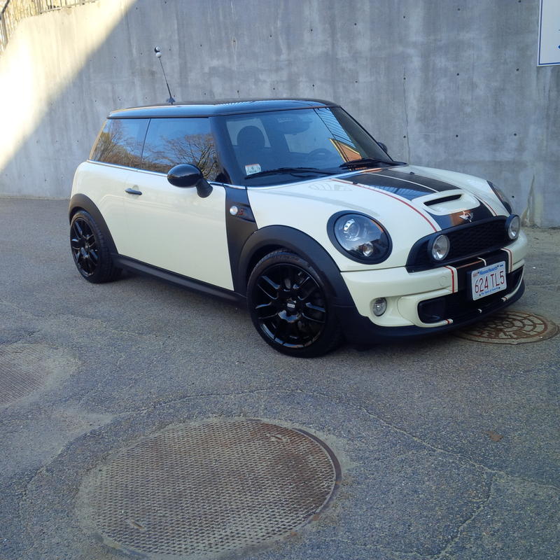

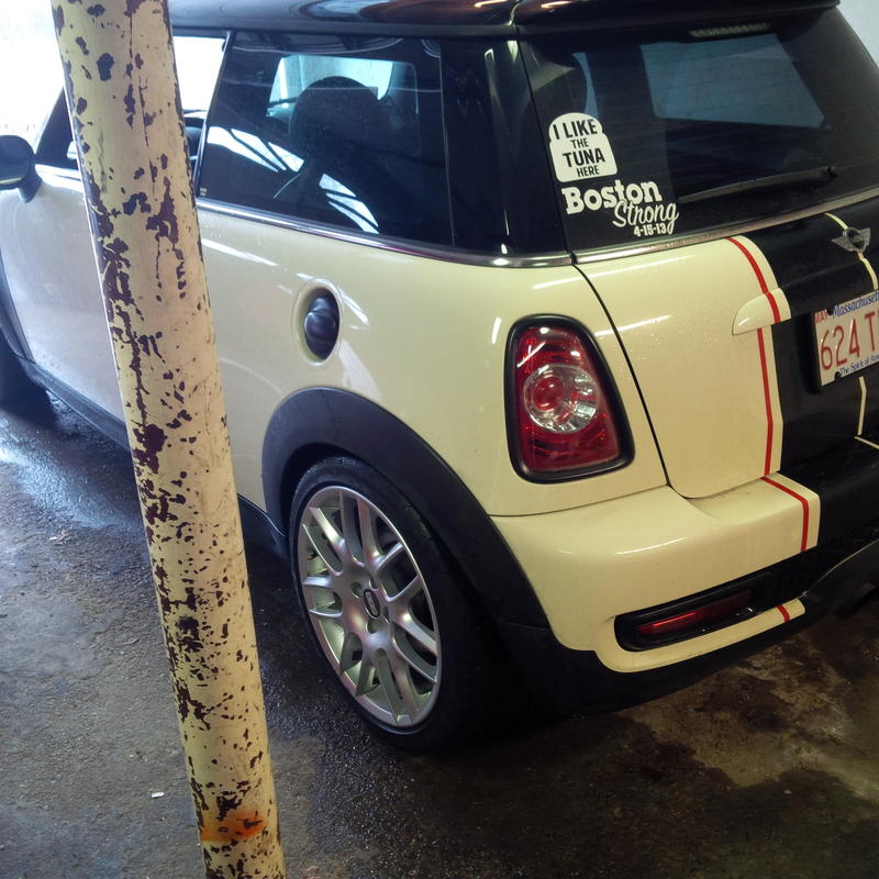

Old May 9, 2014 | 01:32 PM
DOtheDEW's Avatar
DOtheDEW
Posts: 361
From: Boston, MA

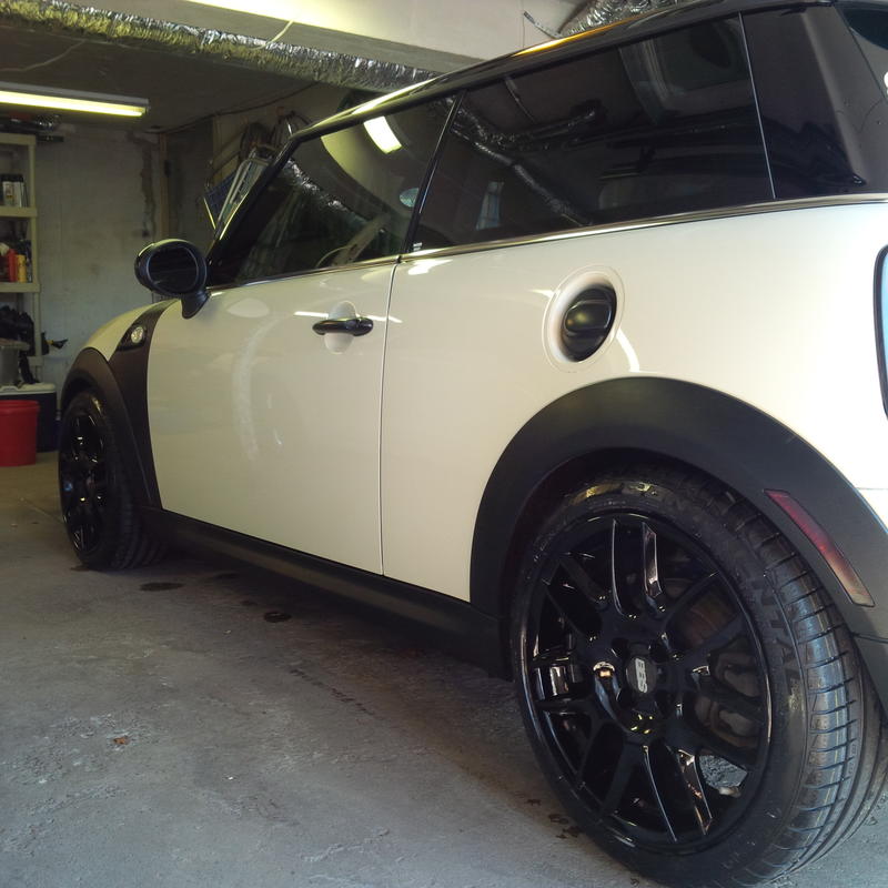

very happy with the outcome of the wheels!

Old May 9, 2014 | 01:45 PM
fallen002a's Avatar
fallen002a
Joined: Aug 2012
Posts: 8
From: Lisbon - Portugal
Realy nice!! I was about to say that you should blackout the beltline but then I noticed on the second picture that you already have xD
Old May 9, 2014 | 03:01 PM
DOtheDEW's Avatar
DOtheDEW
Posts: 361
From: Boston, MA
haha the middle picture is the most recent so yeah its blacked out now hahh
