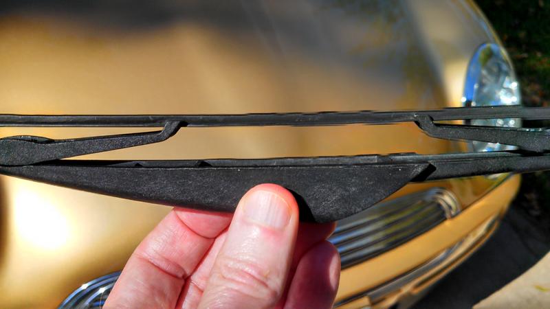

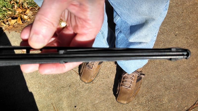

Originally Posted by rwkeating
I am not sure what you mean by a plastic carrier. On my '06, I just pulled the old blades out. On the front I think I ended up destroying the factory blades but they came out without damaging the the remaining parts. Maybe the '05 is different? Got a picture of what you are talking about?
You can see in the picture the slot in the middle of the plastic carrier which runs the length of the arm. This is where the rubber refill slides in. I haven't been able to find a rubber refill narrow enough.
Attached Thumbnails '05 rear wiper replaced with Anco refills-img_20131130_115041_569.jpg   '05 rear wiper replaced with Anco refills-img_20131130_115047_876.jpg   '05 rear wiper replaced with Anco refills-img_20131130_115031_721.jpg
Old Nov 30, 2013 | 10:00 AM
rwkeating's Avatar
rwkeating
Joined: Aug 2006
Posts: 552
Likes: 11
The refills I have are narrow enough (unless the '05 arm is different than my '06). That was why I made sure to include the sizes (in mm) in my post. Sorry I can't be of more help.
