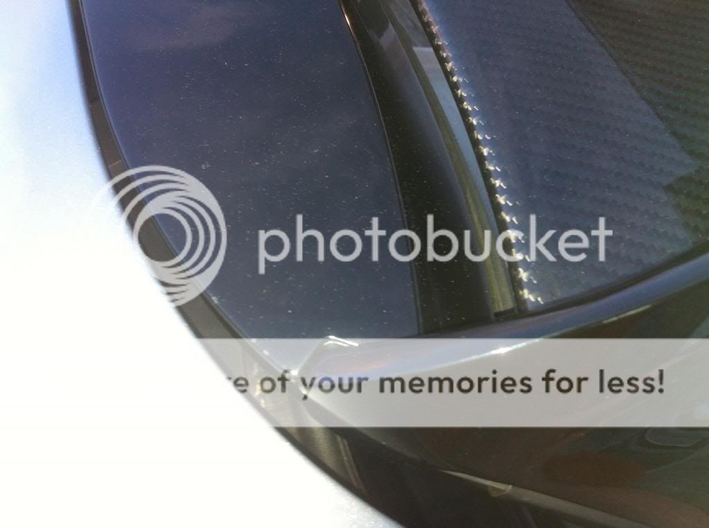

Hey KF.
I took a good look at it just now and took a few pics- doesnt appear to have any special glass at all with regards to the spoiler. The GP does have a different glass than a standard R56 because of the rear wiper delete... maybe that is where the GP specific glass hooplah comes from?

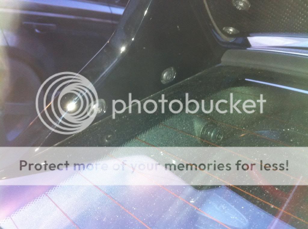

It looks like the side uprights have a clamping system that has 2 torx bolts that pinch a "U" channel sleeve that secure them to the glass.
I did notice that the top fascia is contoured to incorporate the rear spoiler- probably something that the aftermarket kits do not offer...

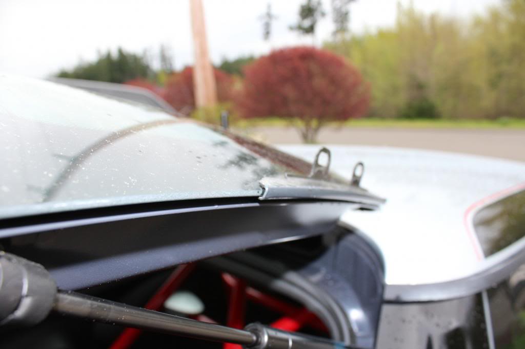

As I thought- this is untrue. I removed my spoiler to get the facts rather than rely on heresay.
The spoiler supports mount to the glass using a removable "C" channel bracket. The top secures to the roof just as a standard spoiler would mount- to the hatch using 5 10mm nuts.
Pictures are worth a thousand words so here we go:
removed these 4 torx nuts first- two per side:
remove the rubber caps to get to the 10mm nuts

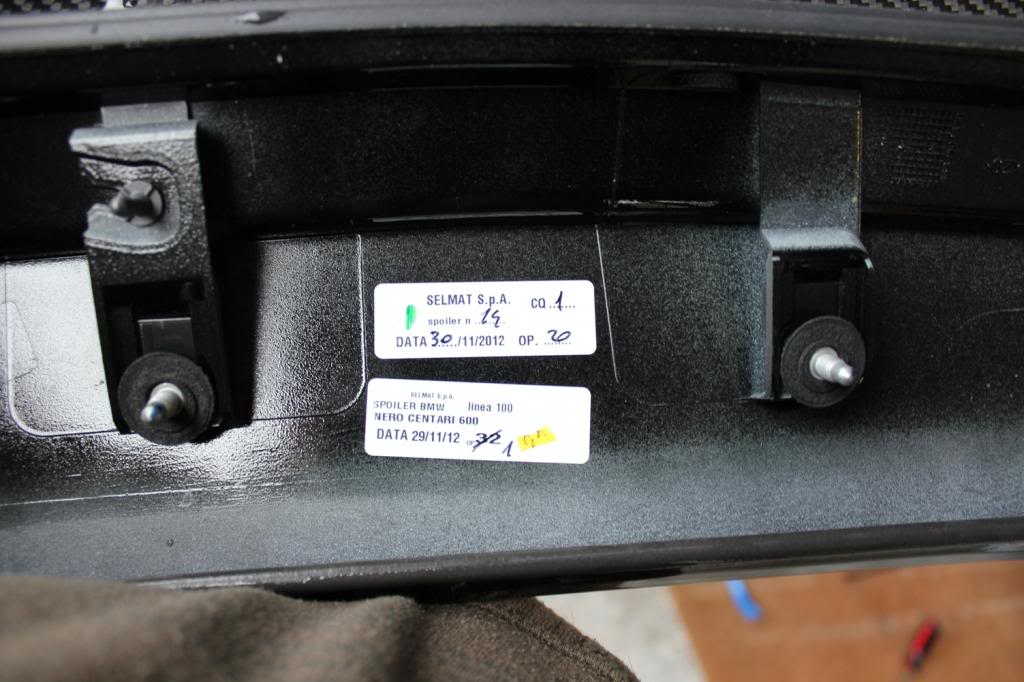

here it is off the car:

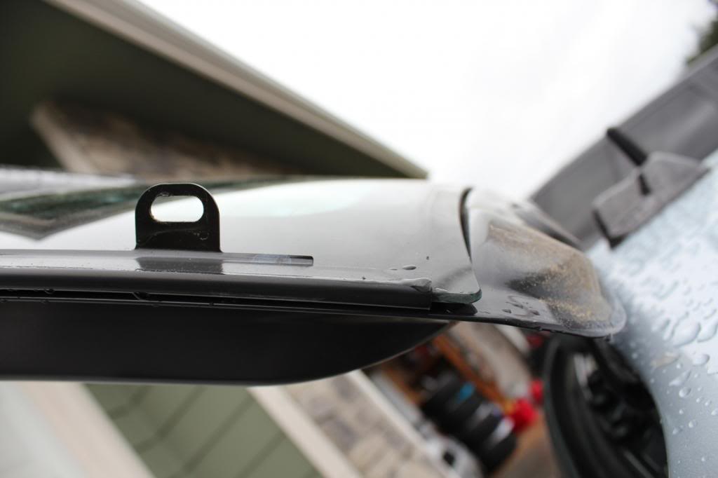

side/upright support brackets

I can get the rear spoiler from my dealer. The issue I have are the little metal flange things that are taped or glued on to the glass and part of that strip in the pictures above.
It's not special glass, but if MINI won't sell those things separately, then buying the rear glass maybe the only way to get them. I can't seem to find a part no. for those pieces. They are the ones in the 2nd and 3rd pictures from the end above.
