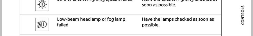

So I have no fog lamps on my 2010 Clubman
then what does this error mean

Found it!
but I seems like my
low beam works fine?
