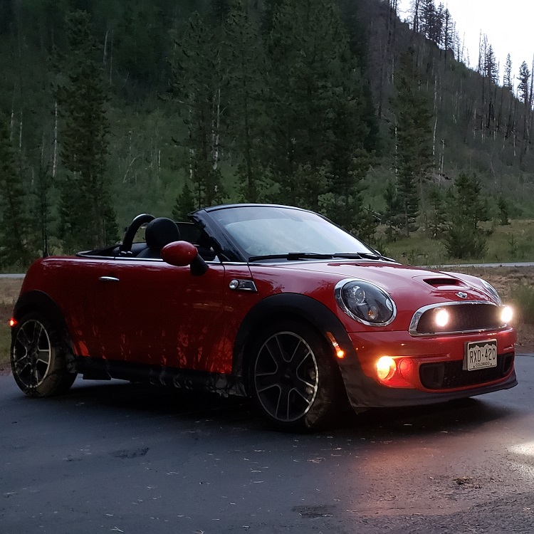

I've got KCs on mine. Mounting brackets are from MiniMania. My husband also put a 10" KC light bar in the grille of his JCW.
