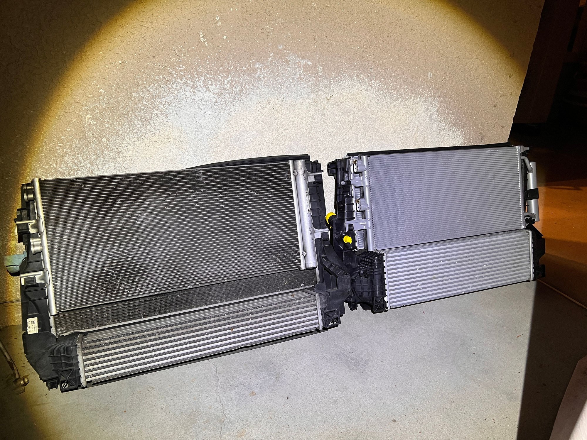

I have spent the last three months maintaining and up-fitting a 2015 F55 base cooper with the front bumper and cooling components from a LCI 2 JCW and just had the chance to push the car recently. I did this because the Forge intercooler for the B38 cars is quite expensive and for around the same price I could swap the entire cooling system over. Here are the findings.

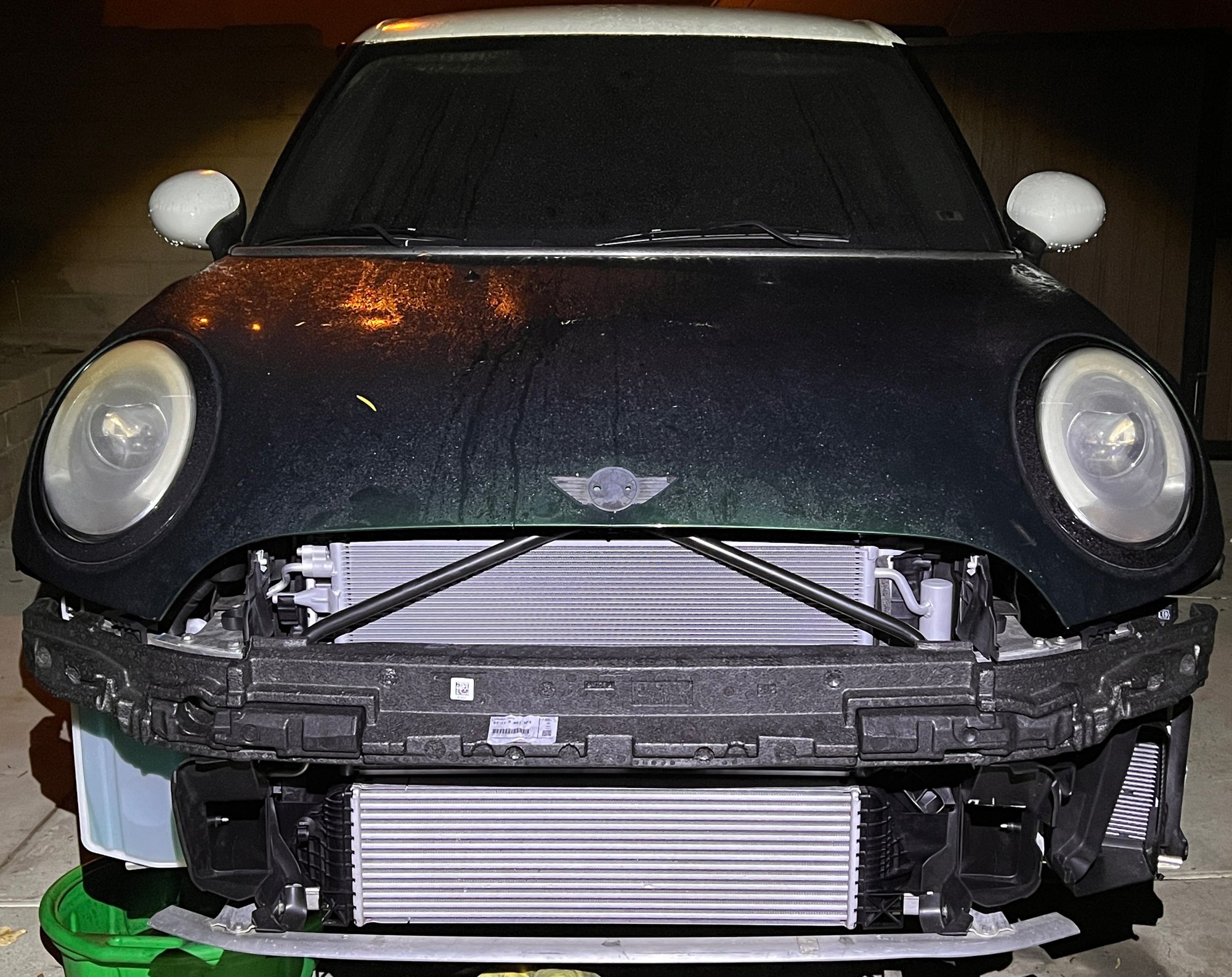

  1. Fitment: The radiator, intercooler, evaporator, charge pipe, boost pipe, and auxiliary radiator from the F56 JCW all fit on a B38 car (with some custom fitment required for the aux rad if you don't buy the JCW support rail)
  2. Performance: IAT's on the base intercooler package (for a 20c ambient day) would have a delta T of 25-35c over ambient under heavy acceleration in the 40-70 mph range for a fully warmed up car. The JCW intercooler drops IAT delta T down between 8-15c above ambient which I was very surprised about. Caveat being the GP3 intercooler I have is nearly new and the stock unit was 10 years old and quite dirty. The rad + aux rad combo kept coolant temperatures around 98-105c pretty consistently and the 850w fan brought temperatures down a lot faster if I stopped quickly after a hard run.

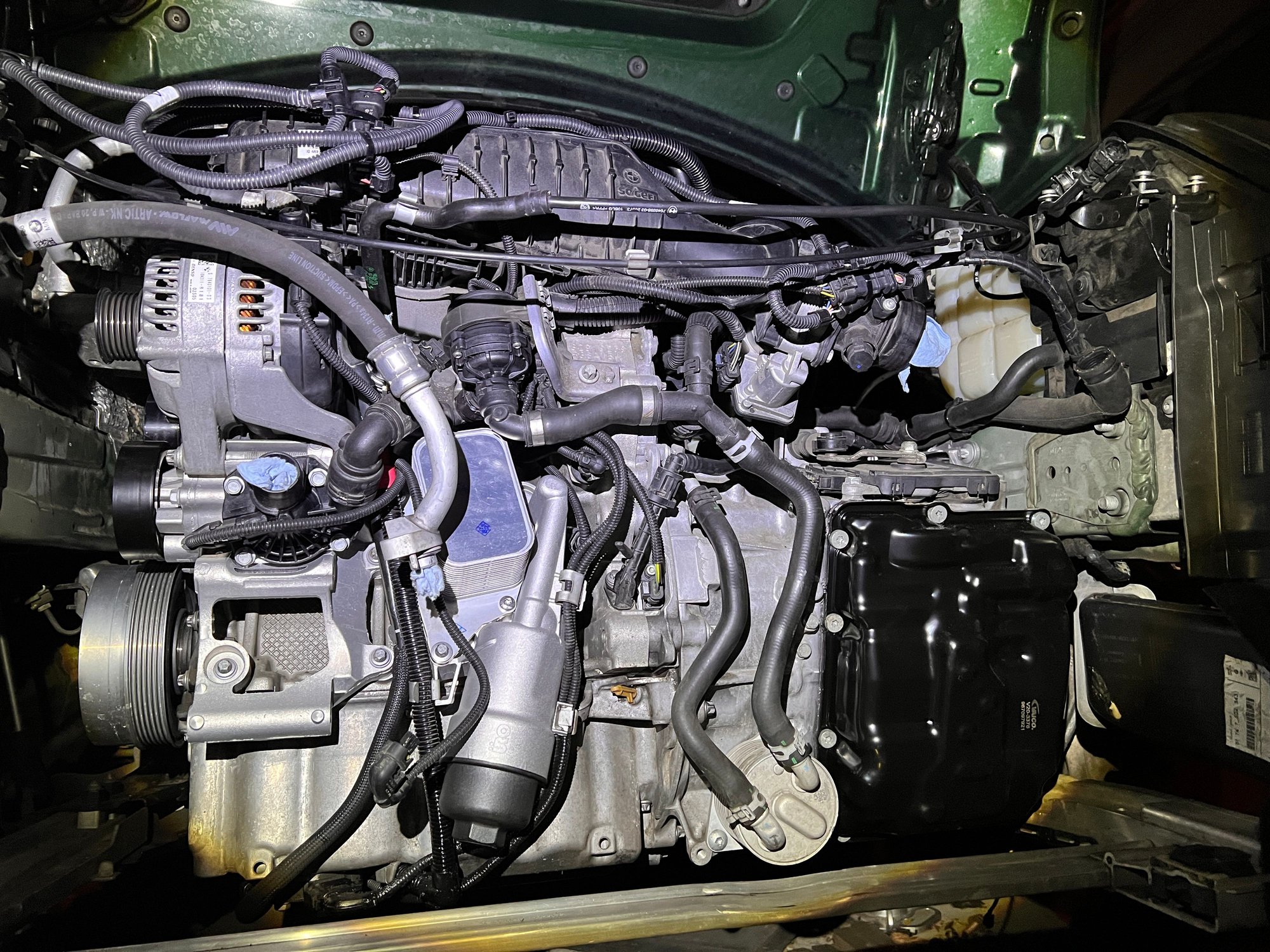

  3. While you're in there: Because of the age and mileage of my car (10 years 82k miles) I elected to replace: the oil filter housing with a URO metal unit, Rein Metal coolant outlet fitting, all EPDM coolant hoses, Oil feed & return o-rings for the turbo, GP3 upper engine mount, and many more things.

Factory Cooling System
JCW/GP3 Parts installed
Size comparison
Size comparison

Blocked intake snorkel before being cut out and resealed
Blocked intake snorkel before being opened up and resealed

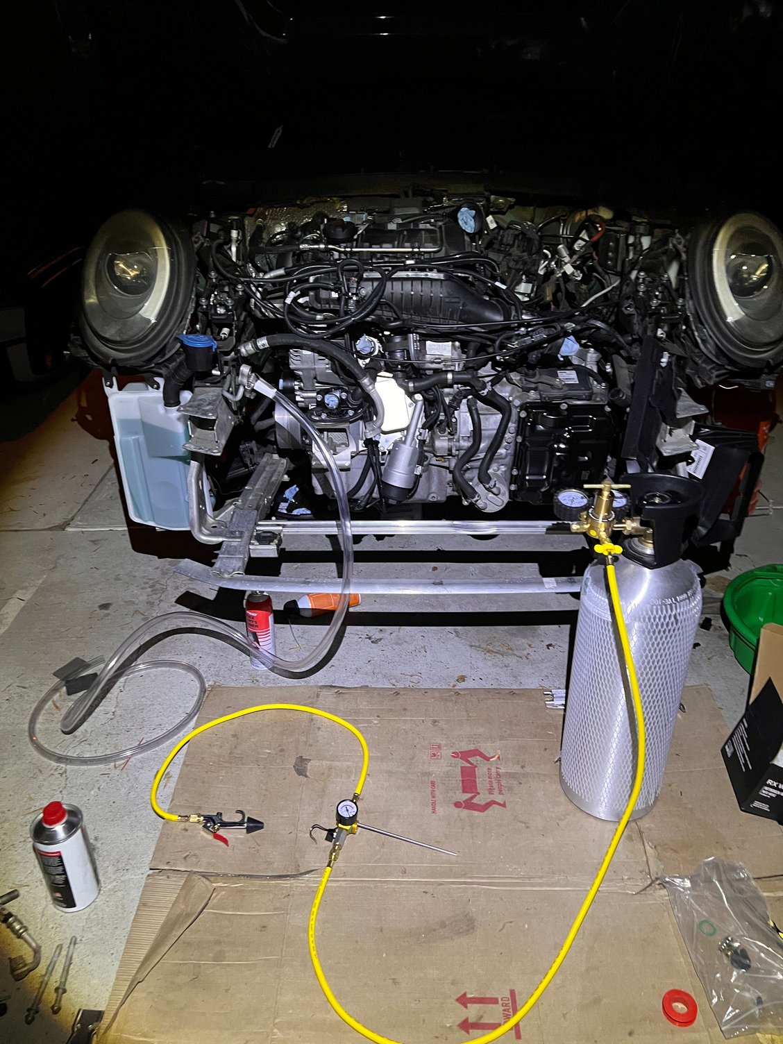

AC line and evaporator flush
New Oil Coole
New Oil Cooler and other parts
Replaced a badly dented transmission pan and resealed

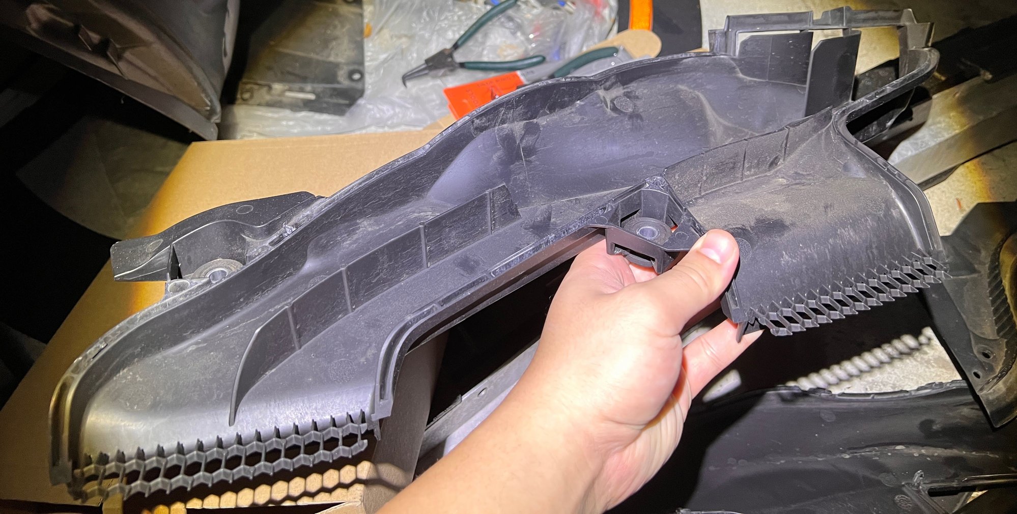

Aux rad duct
Aux rad duct
