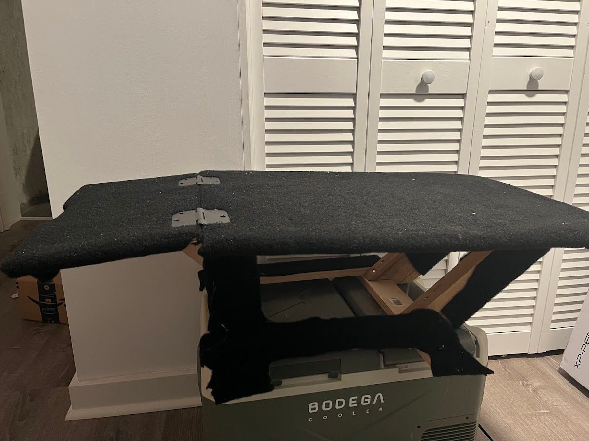

I built a deck to replace the front seat, this deck would allow me to get a twin bed length in the car as well as provide additional storage. I added a hinge so I could use the backseat passenger area as storage. The deck also holds a 40 inch folding table firmly.

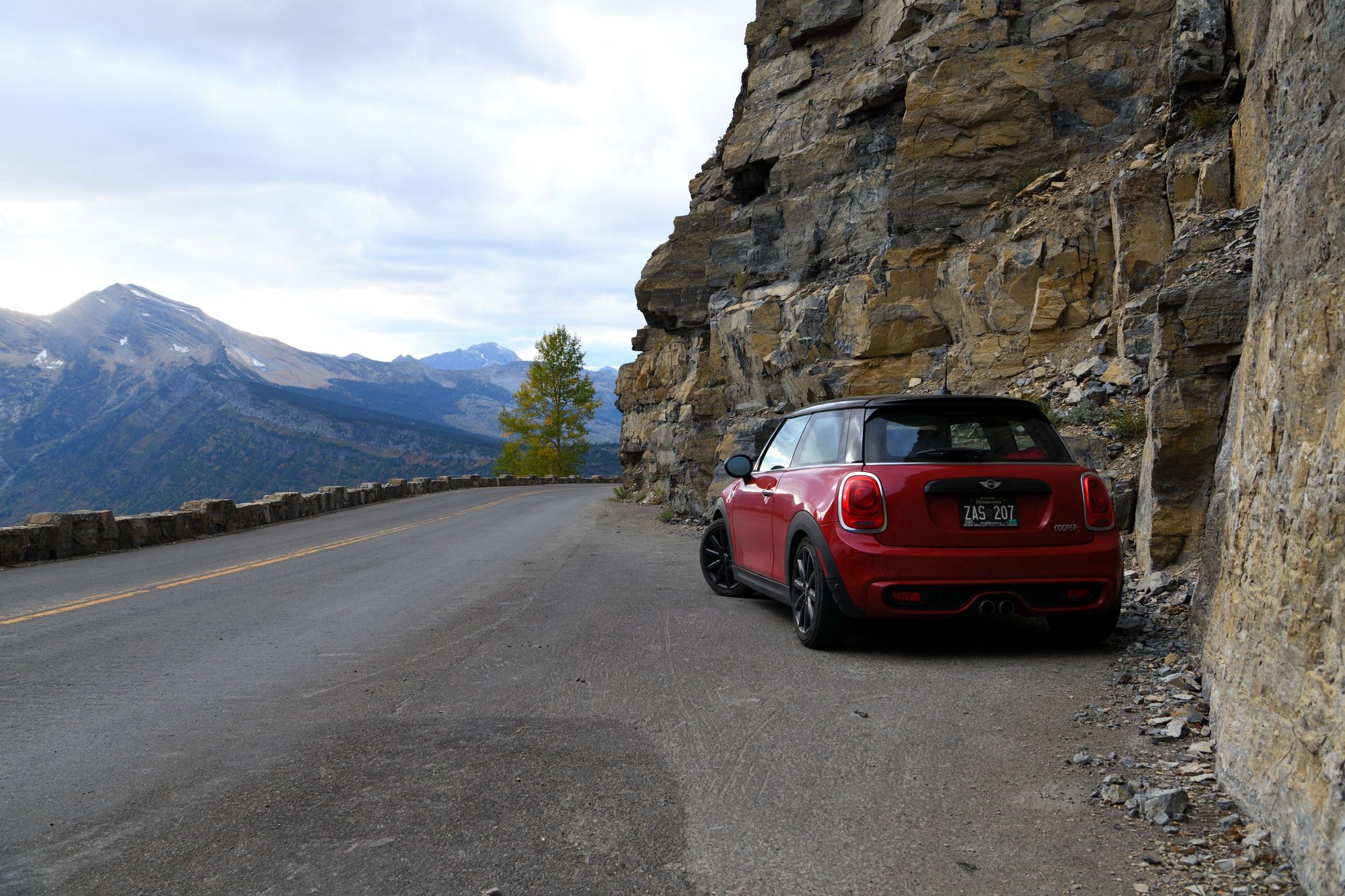

Going on the Sun Road

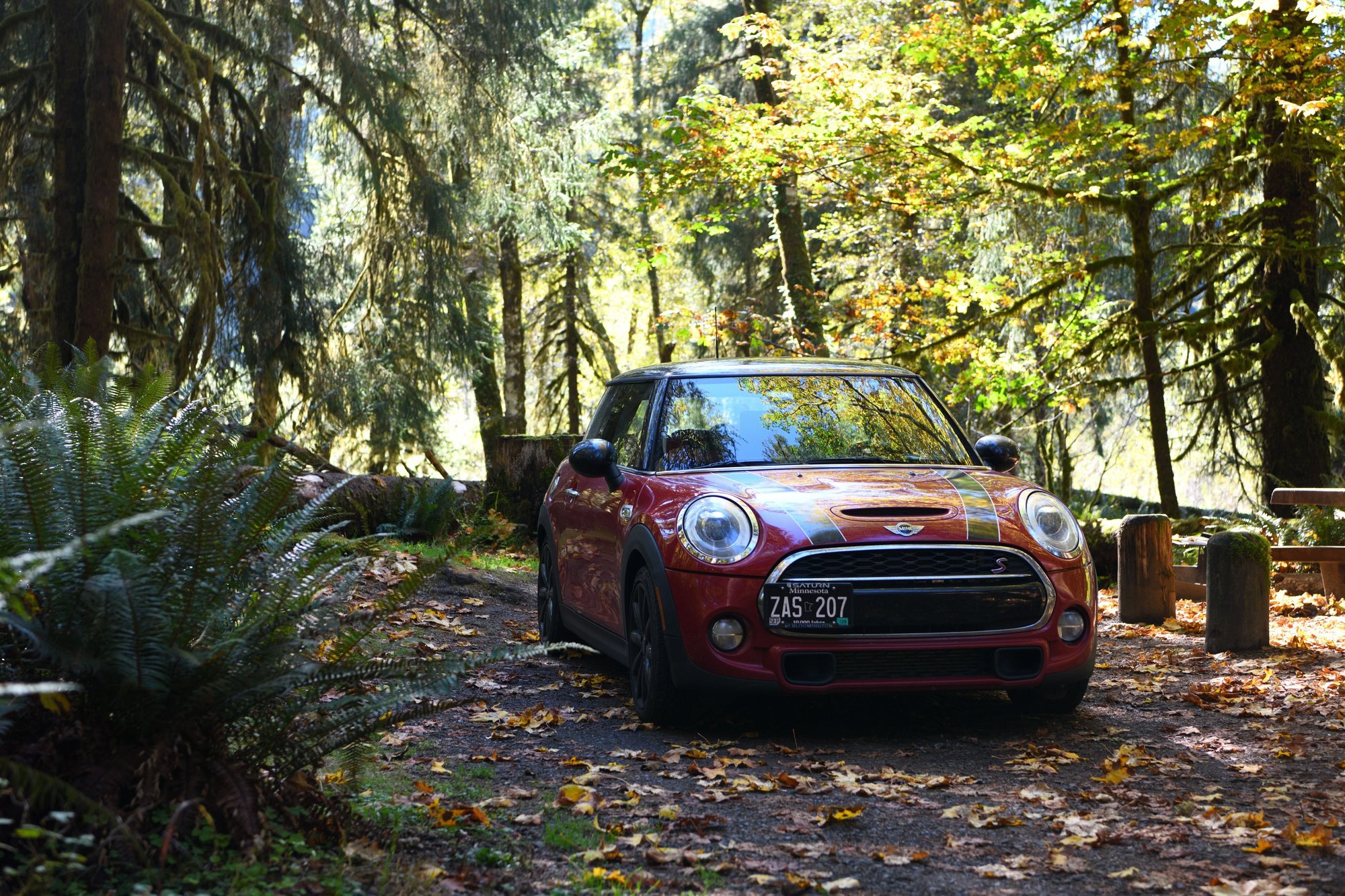

Hoh Rain Forest camping

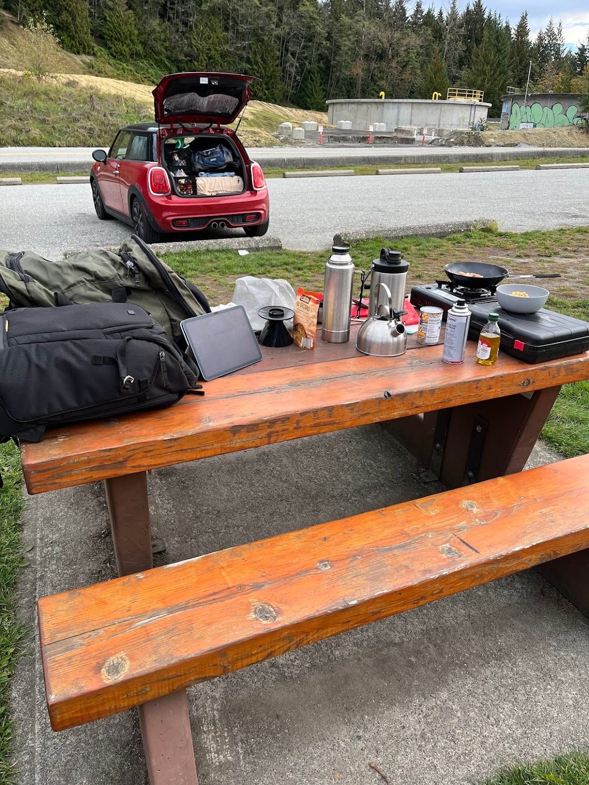

Cypress Mountain in North Vancouver, making breakfast
