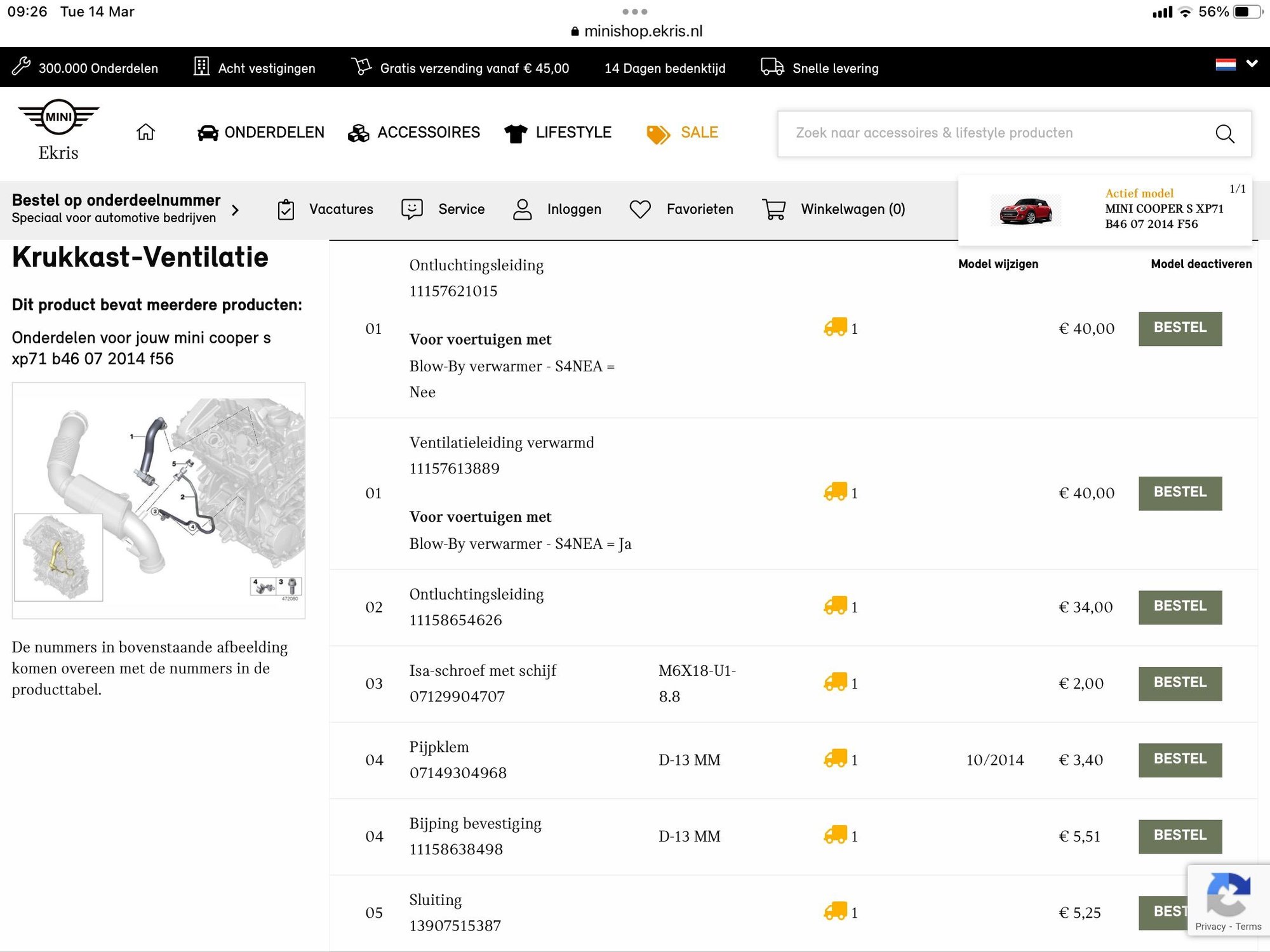

Old Mar 15, 2023 | 06:15 AM
Speedy-218's Avatar
Speedy-218
Joined: Oct 2020
Posts: 31
Likes: 14
From: Netherlands
Hope this helps!
From Dutch Mini Dealer parts catalog online.
Part numbers are international.

Thanks. Found this writeup, which confirms (among other things) that outside of those 2 hoses, there is a lot of mystery here diagnostically, because the rest is embedded within the cylinder head:
https://bimmerprofs.com/ccv-turbo-engines/
