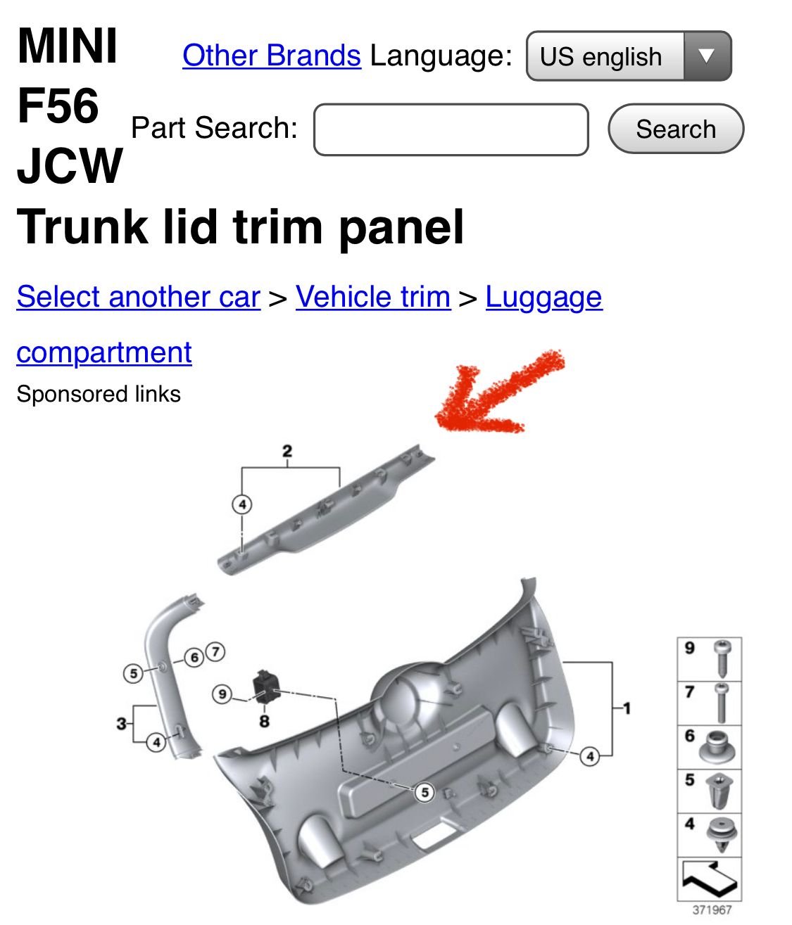

Flashing brake light module install.
Any ideas on how to remove this trim piece?
I’m thinking of installing a brake light flasher and I assume the 3rd brake light is accessible behind this trim.

You can either use your fingers, credit card, plastic trim tool and wedge under the plastic part where it meets the glass and pull up. Pretty simple to do. After the first time you do it you realize it literally takes ten seconds to accomplish this.
