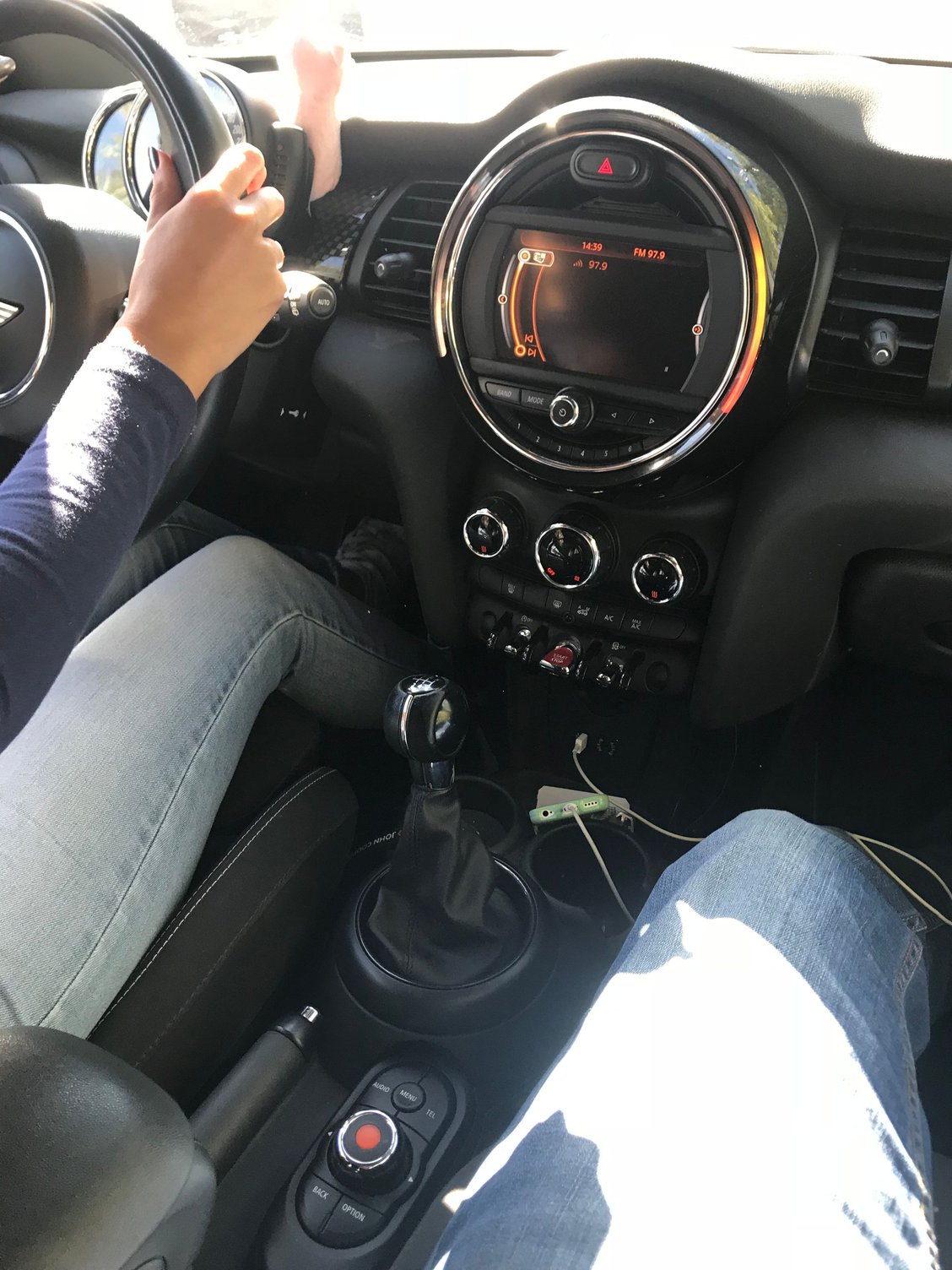

Yes, I already check if the valve was open, so that is not the issue, regarding the sport mode, my car doesn’t have the driving mode selector, so I can’t choose if I want green, mid or sport. Maybe that’s the issue.

wait ...... the Mini S's in Mexico dont have a driving mode? How is that possible? I can't imagine Mini would make 2 completely different versions of Mini.
Can you post a picture of your interior? Im blown away if this is the case.
Sorry if Im coming off as a jerk. I knew there were differences between UK/USA but not USA/Mexico versions. Especially no driving mode
