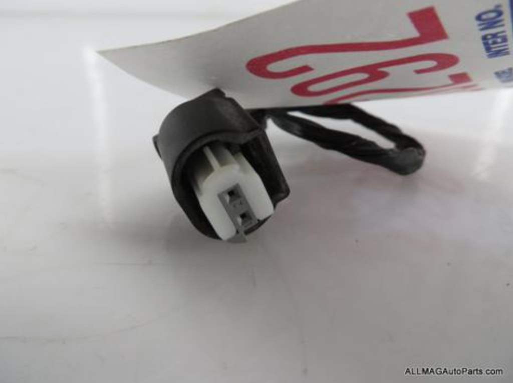

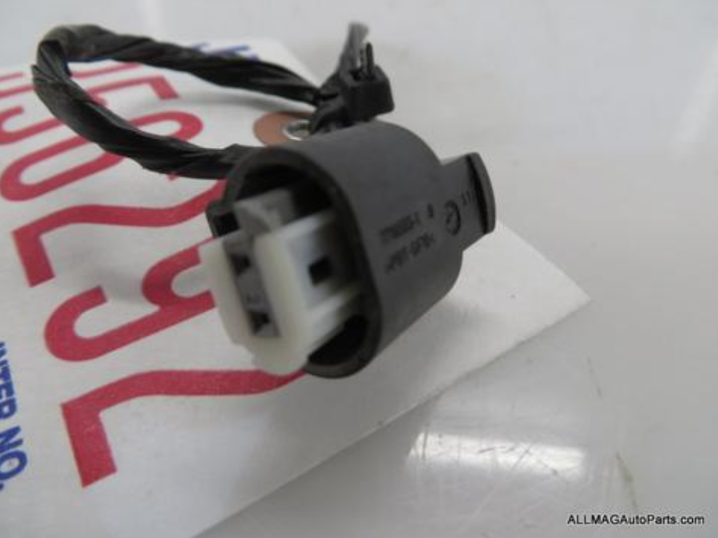

Allmagautoparts have for sell both connectors from a donnor car but each one cost USD 40 and a repair kit only cost between USD5-10

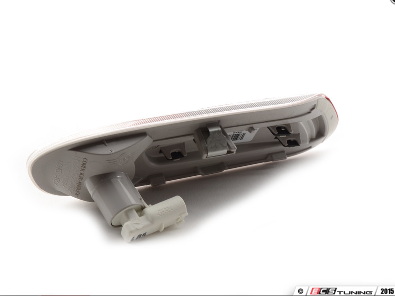

The 2 pol is going to be the closest, MINI used to have a different design for the side marker and pretty much all marker for Gen 1 and gen 2, Gen 3 looks like a different design. But still close to the same. It should fit and is snagged by the new side tongue design. Which the old design is like the plug you show, the only thing that might be different is that small triangle insert, but as you can see below the new plug should not be blocked by it. I would get 2 of these on order and the new side markers and give it a shot.
MINI changes the fix parts on the plugs vs. the original plugs but they still work as it did for my gen 1 MINI wheel arch lights.
63137368763 Left JCW
https://www.ecstuning.com/Search/SiteSearch/63137368763/
and
63137368764 Right JCW
https://www.ecstuning.com/Search/SiteSearch/63137368764/
Socket 61132359999
https://www.ecstuning.com/Search/SiteSearch/ES2798620__ES3075788/
Hope that helps.
