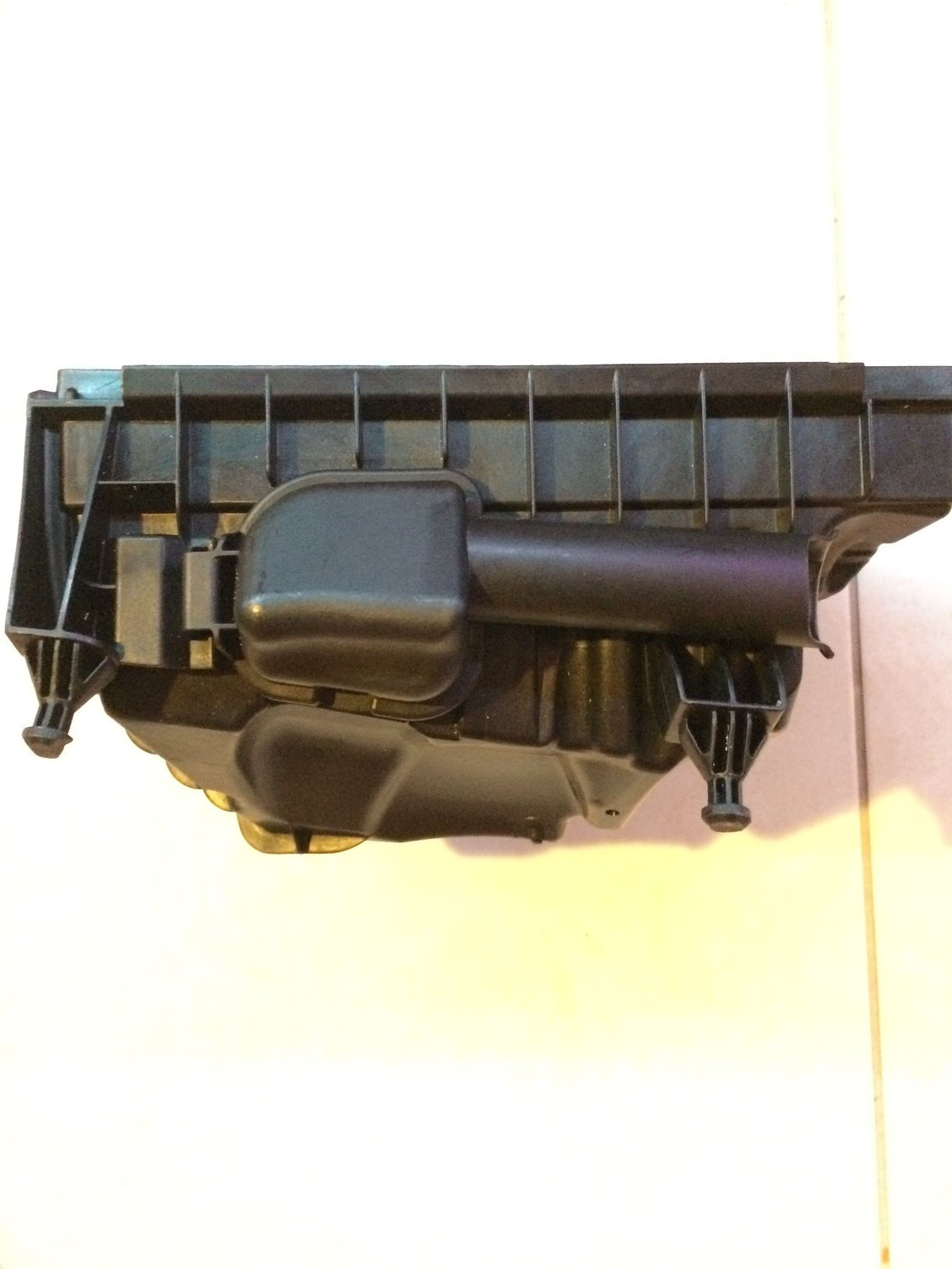

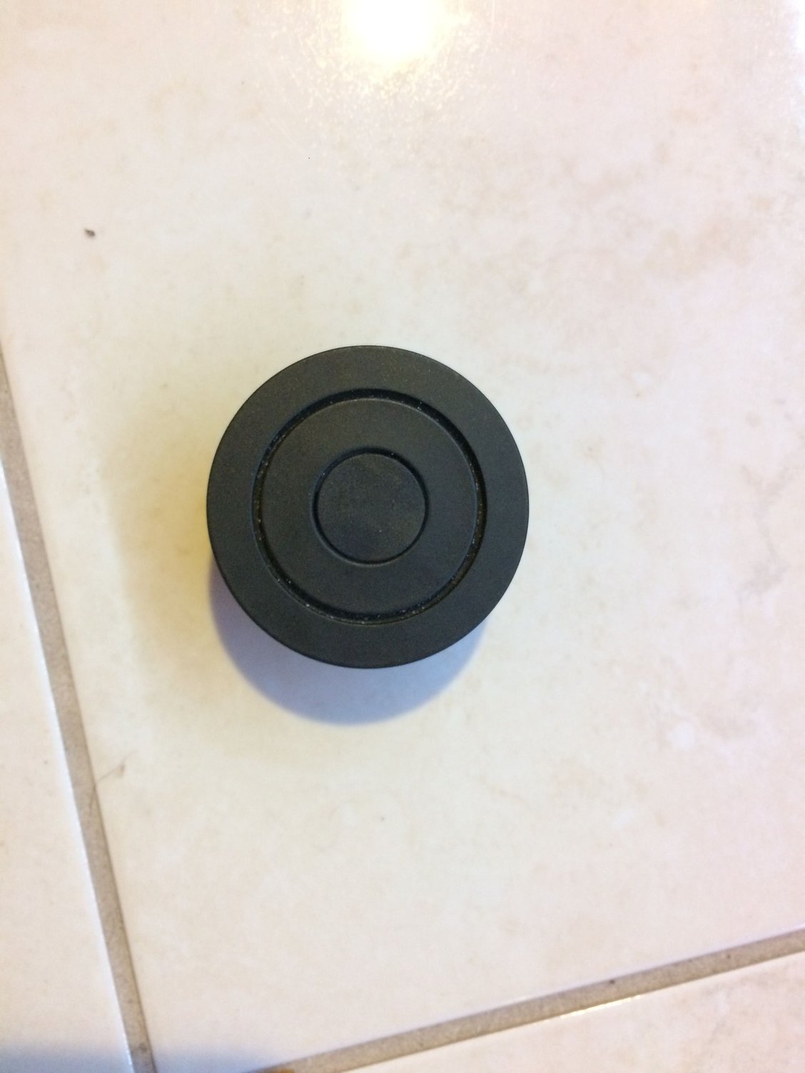

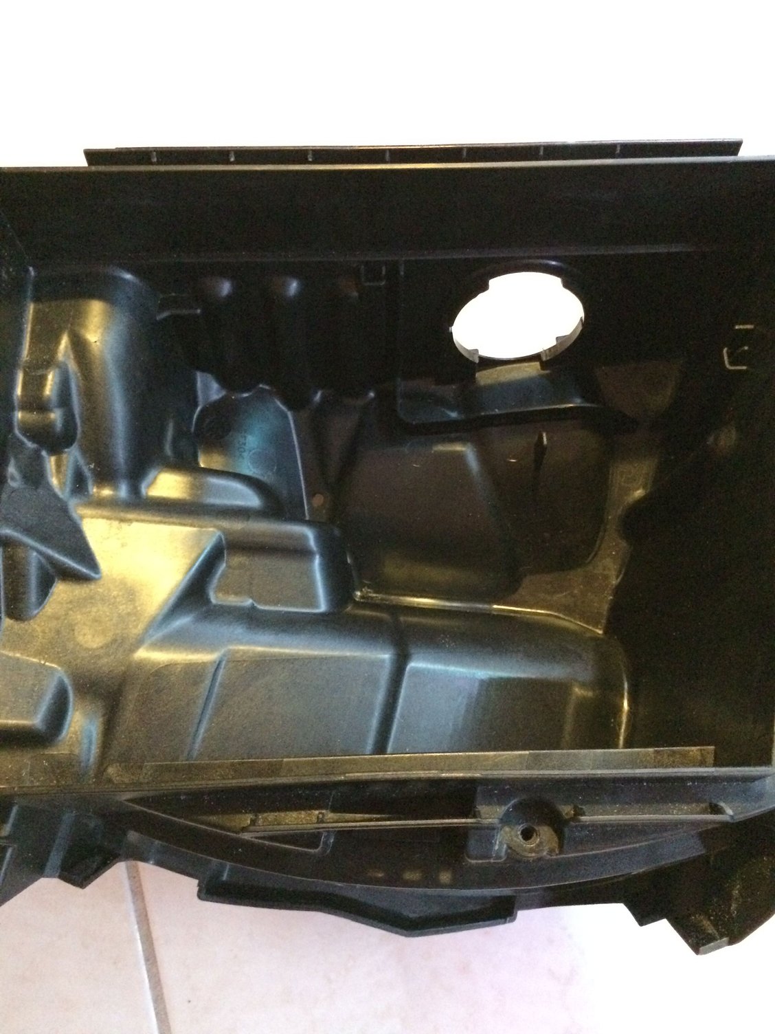

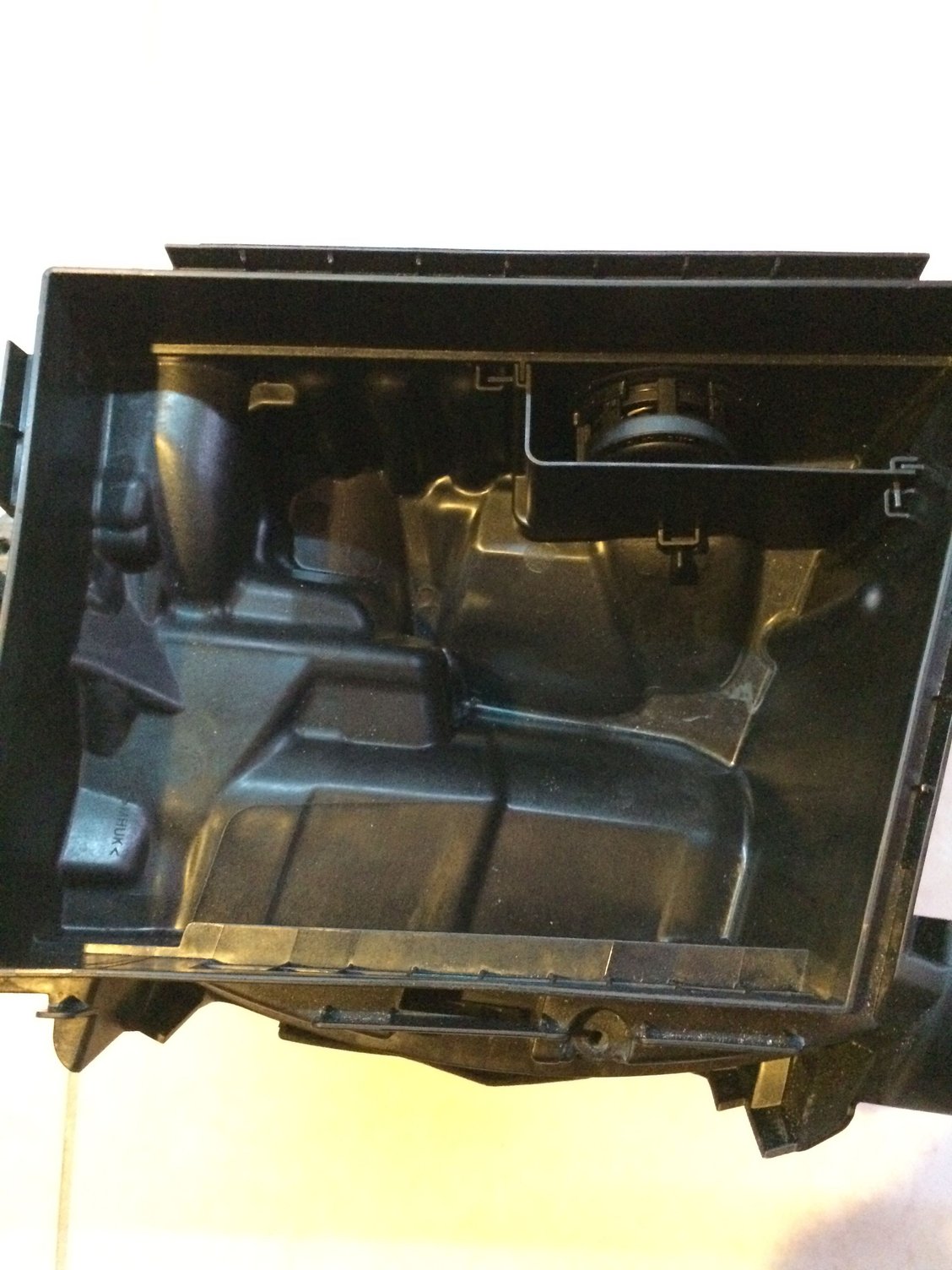

Couple of questions!!! I know that someone may help me on this...
-If "A blow-off valve is not used in current models", from where do we get the typical BOV sound (which for me come from the passenger side of the engine)?
-Also, my air filter comes with a foam pad (can I remove it?)
-Does anyone noticed that the stock airbox comes with a "check valve" on the back, that draws hot air from the engine? Any idea of the purpose of it?
-What about the bigger tube in the intake pipe?? to change the air pressure before entering the turbo? Something to do with the PVC lines???
Thanks!!!
Thanks!!!
I'm not sure where the sound is originating. The lack of a diverter aka blow-off valve is actually news to me.
Foam pads on air filters are usually used in abnormally dusty or frosty areas. Given your area, neither sound applicable.
Does your airbox innards look different than my picture on the previous page?
Lastly, the large cross section of the intake pipe from the airbox to the turbo is a resonator to minimize induction sound into the cabin. It's also where the PCV lines enter, however that's just coincidence.
Hope that helps!
Hope that helps!
Hope that helps!
Hope that helps!
Yes, my airbox is different. I'll take pictures as soon as I get home. As for the foam, I'm from Puerto Rico, so snow its not a problem, dust? Maybe... But I also vacuum the filter regularly (Every two weeks) and I will replace it later on with a K&N or anyother drop in... Its going out! As for the intake respnator, I've been thinking of making a good quality replacement tube to try to get more sound from the turbo, its extremely quiet... ***I'm not expecting to get a huge amount of sound as the turbo is quite small, but something is better than nothing...***
Oh that is quite different. I also haven't been able to find it in RealOEM database. I can't think of a good technical reason to inject hot air into the airbox, or why there would be a check valve there.
As for the turbo sound, for sure you can get more compressor sound by removing the intake muffler and resonator, but just for the record the size of the turbo doesn't dictate its loudness, however it does typically affect its pitch as smaller turbos typically spin faster. The turbo in the Cooper S and JCW aren't small unless you're used to a GT35R being average-sized, which would be a fairly skewed perspective in an OEM context.
Cheers
Cheers
