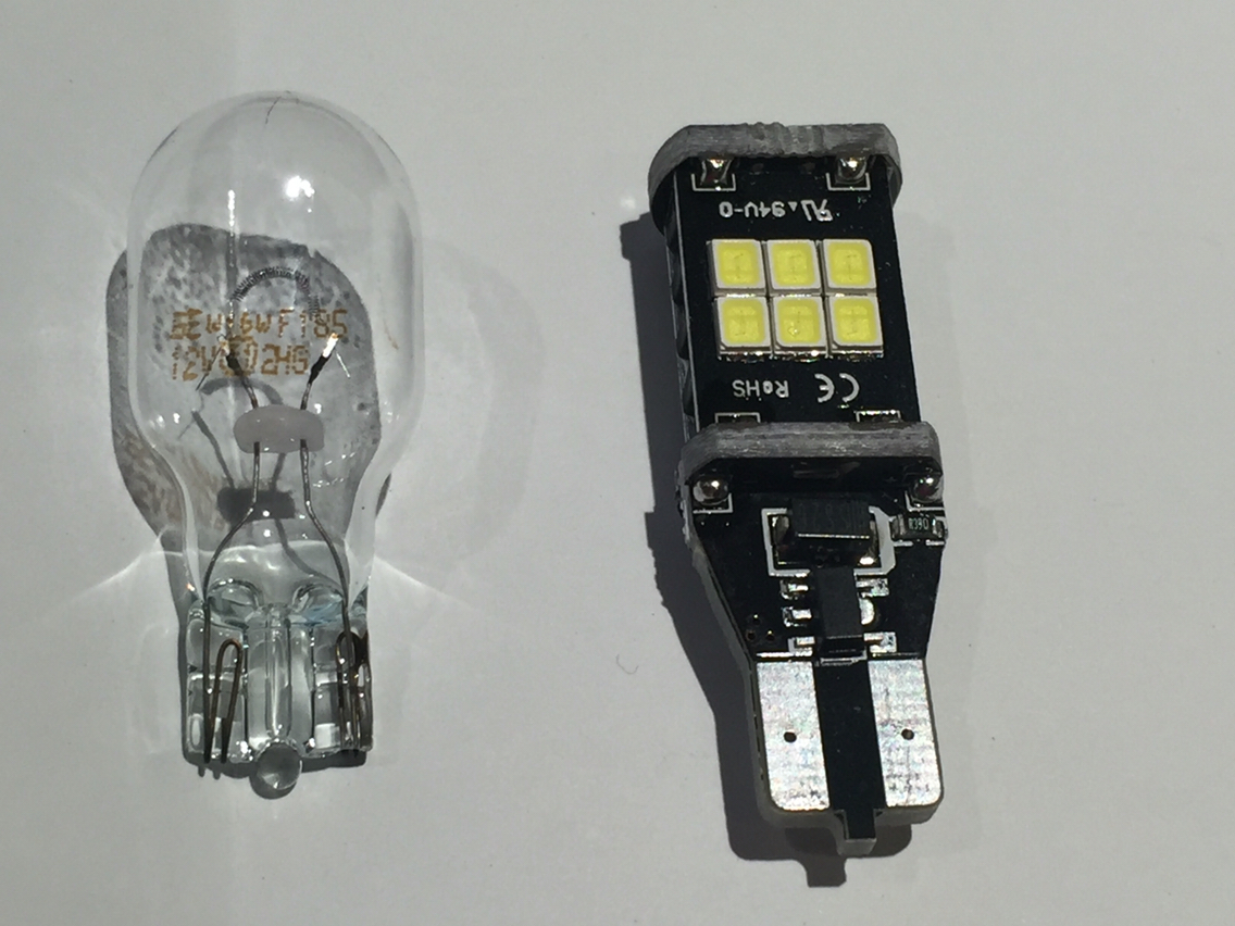

Could swap for LED upgrade , do you have a pic of the bulbs.
Would be interested in this if it didn't start throwing codes.

for the record, user manual states the rear fogs (for the S models) are W16W bulbs.
We have canbus bulbs I could cross ref if you want to try, as long as its canbus , should be no codes.
I actually got some Canbus bulbs... will try.

Well I did the swap. First thing is that the instructions in the owner manual are not so accurate. Needed to actually pop out the fog light assembly.
It is brighter now, but not amazingly bright or anything like that. At least I won't have to worry about the bulb burning out for a while, theoretically.
