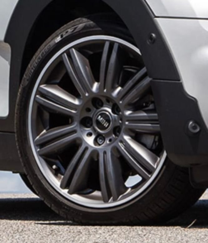

Still not so comprehensive. I was told to stay away from slotted or drilled, they will just rust away in canada. I’m fine with that. I’d really like to have the hat come painted/coated since my own brakes are rusted to hell and look like junk. I was looking at ebc rotors and either Green stuff (I’ve read they are dusty) or red stuff pads (Not sure I’m so into the bedding process or the squeal when cold). Maybe Zimmerman rotors, or I can stick with oem, which clearly don’t last long, are dusty and rusty. My other ask was about the big brake kit. No clue if they fit behind masterpiece style 520 wheels.

I've got 18” wheels for winter with an et 57. My parts guy at the dealer said that he doesn’t think it’s going to fit...so I’m back to rotors and pads. I’ve got super low km on my car for it’s age so the rotors are dying from corrosion from exposure to salt more than age.

Strange. The OEM spec for JCW wheels are 18x8 et57 or 56... they should fit the BBK. are yours OEM wheels?

I had the same thought. The grip spoke style 524 are apparently the only 18” oem that clear. I have these below, style 520 masterpiece that were an option and some other 18” set that’s a BMW replica that’s banged up and out of round.
Funny how fast mods add up. I convinced myself when I need brakes I’d upgrade. I may need to give up on this one. The resale on our car in Canada is sad. For what I paid including all the mods, I can’t think of something else as much fun.
