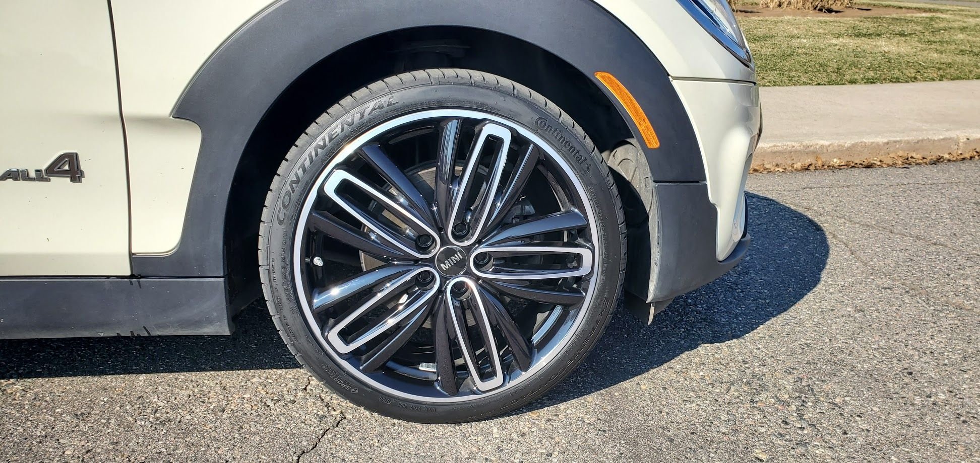

I have both ! I bought my All4 S in Feb of this year, has the Sport Package (Dynamic Dampers) and previous owner added the 19" JCW wheels at Seattle MINI.
I also added non-RFT 235/35/19's when I added a Spare Tire - here
