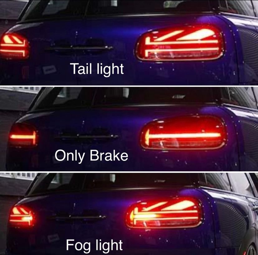

I’ve hijacked this image from a previous thread showing the new UJ taillights using a section of the brake light as the rear fog lights and I know that the pre-LCI Clubmans would activate the fog lights in the bumper but I’m not getting either of scenarios to occur.

I think your LCI taillight didn't have LED chip on rear fog. Because US and EU has different LCI taillight part number.

Honestly that’s probably what it is. I do know that the EU lights have amber turn signal indicators and the US has red turn signal indicators, which could possibly be a reason for different part numbers, but it would make sense that they left out an extra LED in the US lights for the rear fogs.
