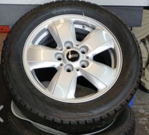

No, guy's selling 5-lug wheels

If those are 15x5.5 Heli-Spoke 492 wheels they probably won't clear the front brakes on your Clubman.

Those look like MINI LA wheel revolite spoke 517 - 16" wheels to me?
