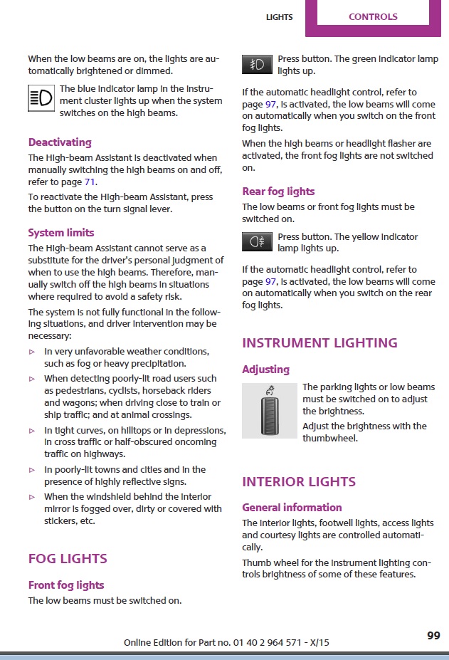

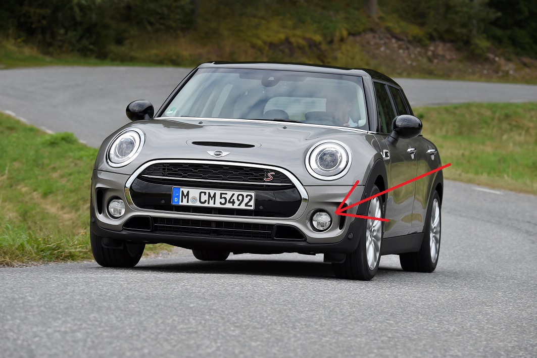

Put down your beer and read the owner's manual and look at the front of your car!
You have fog lights as standard.

No beer needed I do not have this buttons. Also of note I have been to the dealer ship and they are saying it isn't possible.

Interesting. So you have the small round lights in the front bumper below the main headlights, but you are saying they function as DTRLs?

Yeah the top half of the light works as dLRL but there is nothing in the bottom and no buttons besides the light selector to turn them on even if.

OP is correct. The base clubman All4 has no fog-light switch.
There's a light in the bumper but it's not a fog-light, just a DRL.
The photo posted by JohnnyQuest is the "S" variant.

So mine look like that but the bottom half does not have anything in it. I also do not have the switches to turn on fogs

That picture above also shows a vehicle equipped with the LED lighting package rather than the Halogen setup. The DRL's on the LED pkg vehicles is a ring around the upper lights and the upper half of the lower module is just a white running light that is only on with either the light switch on in either the parking/headlight positions and off when the switch is off.
