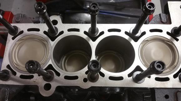

The motors are sleeved. The RMW turbo thread has some photos of one of the blocks. Boring without sleeving these blocks, the water jackets can be compromised or the wall may not have enough material left.
The 1.8 is capable of big numbers, when turbo converted. But, that gets expensive.
