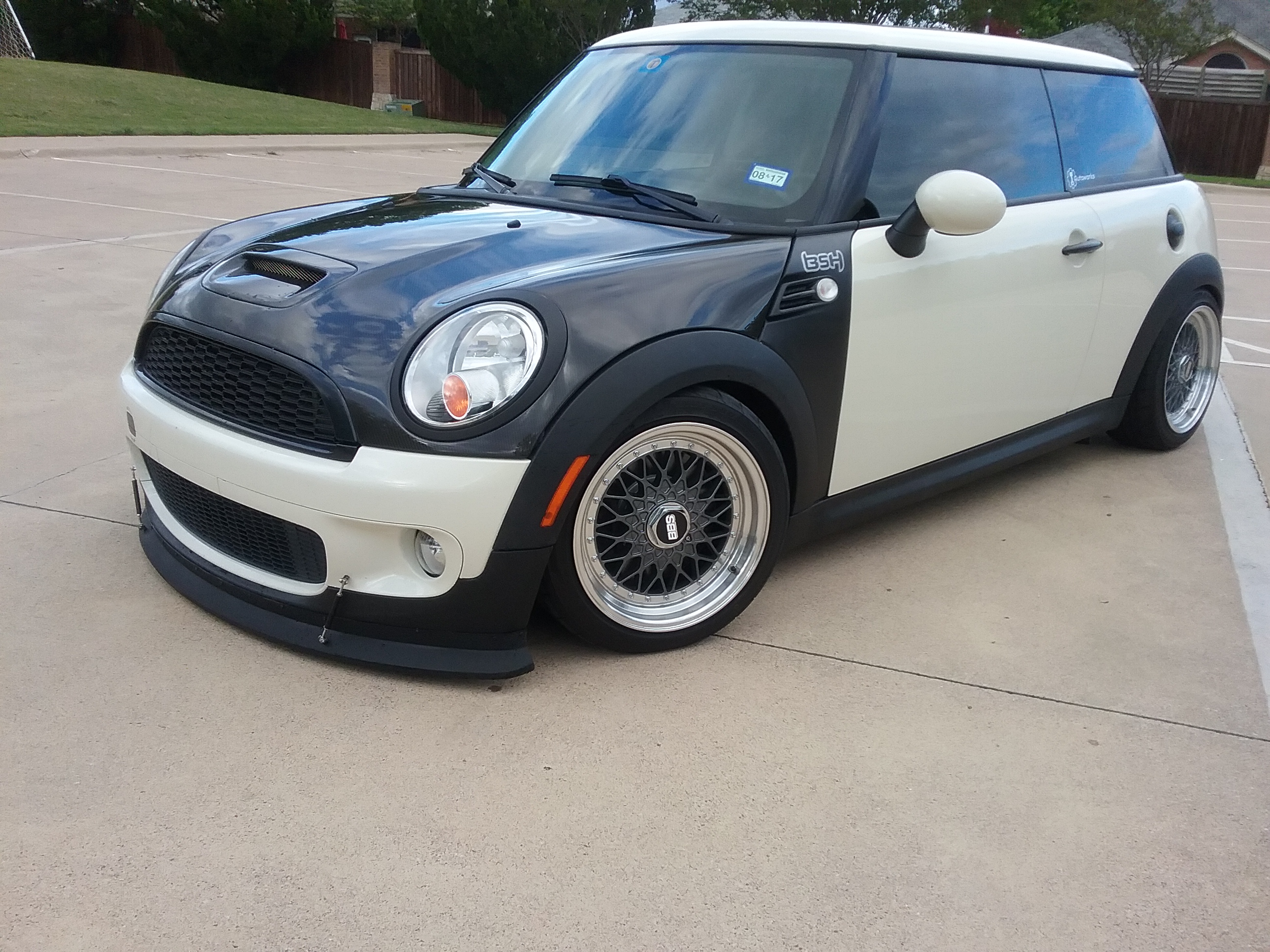

Lots of great advice. Just my opinion since I love to have 300+ hp but I have to be realistic. I am running my 09 R56 on stage 2 manic mods are in my signature and having a blast on daily basis some say 235hp some say 220hp at stage 2 but it is not what my car is capable of it is how I feel about the car I feel good when I get behind the wheel there is enough power there to get me where I am going way faster than law allows with suspension and all the $$$$$ spent just at stage 2 now the car is what I am looking for. Catless down pipe manic tune a great suspension will provide a great experience and most important reliability on a unreliable N14, why not take these steps that don't require tearing down the car first and see how you feel about it then take it to the next level if you see fit. There is my mini and my Carrara S that is done by Texas track works about 500+up, I still like the mini better. Lol
Ben
Attached Thumbnails What should I do???-20170428_083940.jpg   What should I do???-20170402_180534.jpg
