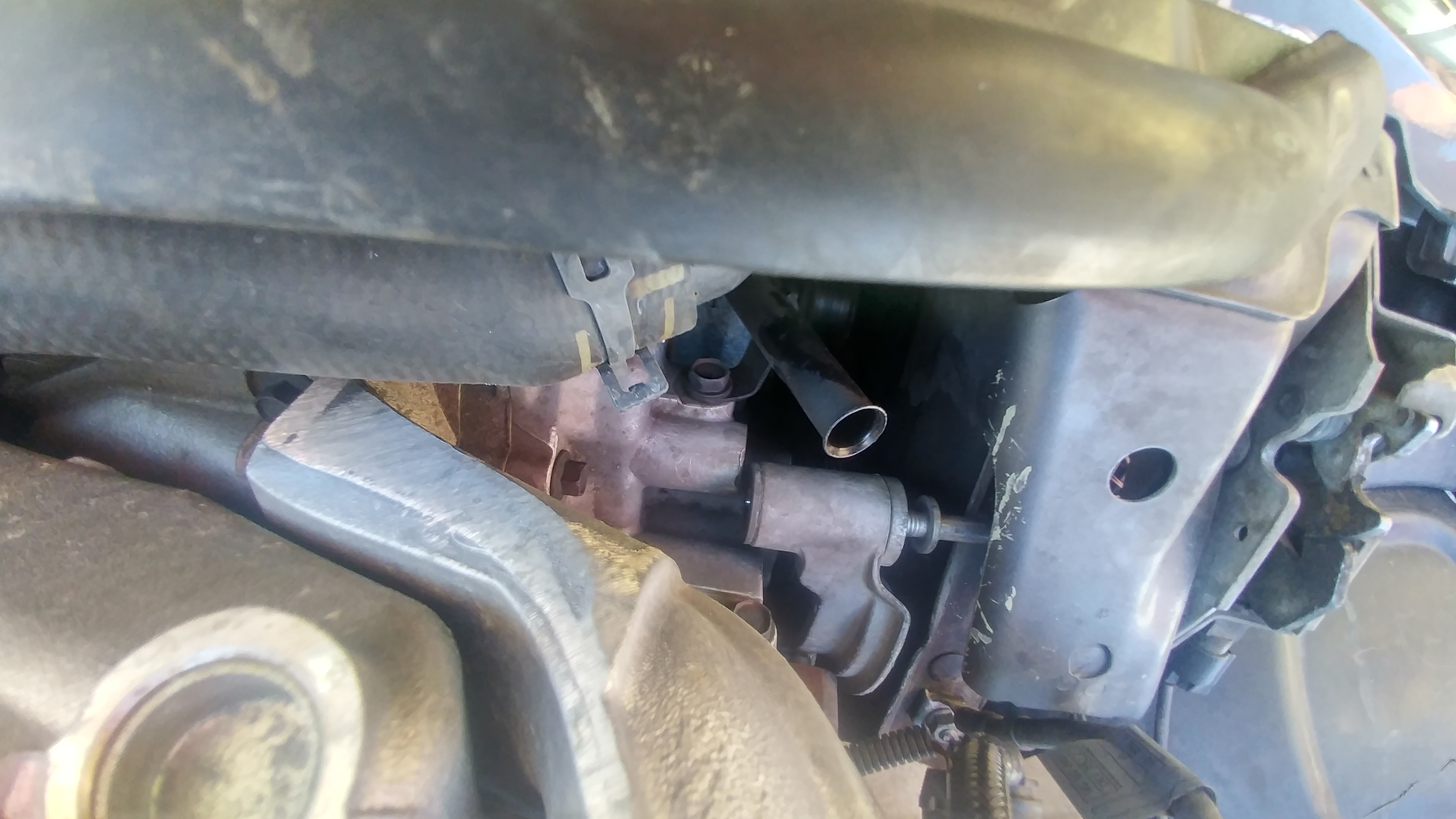

So I am driving for my job about 3 hours ago and as I pull into park I hear a nasty rattling sound and think for sure its the belt tensioner. Turned the engine off. The pictures provided are what I found. No idea what exactly has happened.
I am about to call a tow truck when a guy comes up asking if I needed help. Was a car restorer he claimed. I said no thanks this needs to be towed, but after looking it over he claimed he could fix it with his tool set in his car.
About an hour later we finally together somehow get that bolt back lined up with the tensioner and managed to tighten it down as best we could with as little room as we had to work with. We started the car up and it seemed to be running fine... No more rattles. Never got a CEL. I tipped the guy 100 bucks for his troubles....but did he actually fix the problem? Or did my tensioner break? Or what? And was this problem due to a faulty install with the pulley? I was able to drive the 10 or so miles and stay out of boost as much as possible and now it's parked at my place. Is my car safe to drive? Please advise because without my car I don't get paid

What did you find out?
If the shop did not have a belt tensioner tool, then they most likely loosened the top bolt so that they could use it as a fulcrum for a flat bar (done this myself several times) and they then did not tighten the bolt back. At that location the bolt is mating into aluminum and not cast iron. If they had the tool then they did not tighten the bolt back up.
