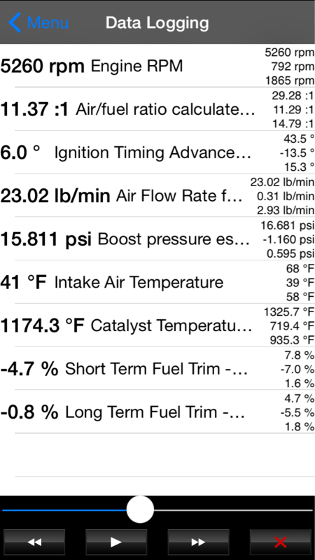

Originally Posted by Indimanic
For those with Dash Command, has anyone gotten the MAF PDI to work?
Mine is all 0.00
Also any Manic Tuned folks w/ N14 motor run into a overly rich condition?
My 09 JCW is dropping to 10.00 under WOT.
I use the following Dashboard: "Portrait Numbers Only"
Manic Motorsport brings us N18 owners OBD II Tuning! Solution is finally here!-image.jpg
Not as flashy, but displays all I need and more. 😁
For those with Dash Command, has anyone gotten the MAF PDI to work? Mine is all 0.00 Also any Manic Tuned folks w/ N14 motor run into a overly rich condition? My 09 JCW is dropping to 10.00 under WOT.
Have you tried just using the data grid option and adding PIDs to this?

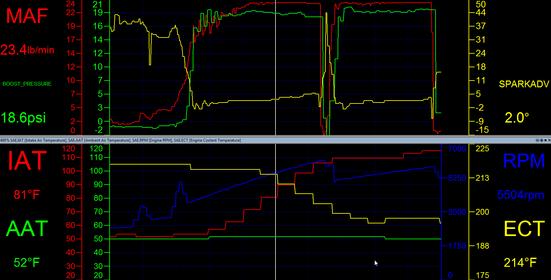

Stage 1
Map A 23.1 lb/min
Map B 23.4 lb/min
Map C 23.4 lb/min
Graph is Map B
Just went to stage 1 last week and I like it.

Originally Posted by pepperwhiteknight
Stage 1
Map A 23.1 lb/min
Map B 23.4 lb/min
Map C 23.4 lb/min
Graph is Map B
Now you need to install a meth kit. Especially when the summer time comes.
