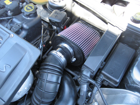

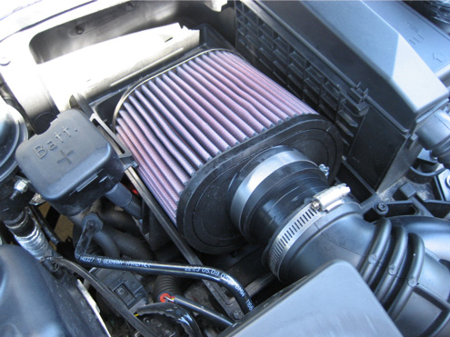

Here's my cheap HAI
I installed a K&N 1540 to the existing intake hose.
To me it made scense (what little knowledge I have) to go to the hose instead of the throttle body. I don't recall the name of the other hose that goes to the front vent to the stock box but I left it in also it would get air from the cowl. Nevertheless this is what I did:
To connect the filter to the hose I used a PVC straight connector joint. It's a piece of PVC around 4" long that's used to connect two 3" pipes. I wrapped electrical tape around is so you don't see the white of the PVC. I had to work it a bit to fit into the hose but it fits perfect to the filter. Clamped it at each end. Then I zip-tied it down. That's it.
It's great. Car does pull more and it's a big help in hard right turns in 2nd (my car always seems to choke here)
and when the AC is on.:thumbsup:
Check thumbs
Attached Thumbnails Operation Hot Air Intake-1540-1.jpg   Operation Hot Air Intake-1540-2.jpg   Operation Hot Air Intake-1540-3w-zipties.jpg

My MA is of the opinion that the HAI (the original set up - direct to the TB) would kill your low end power. Any thoughts? I live in the Orlando area, where it is in the low to mid 90's everyday in the summer, so I wonder if the ambient heat puts the capital H in HAI.
Old Jul 18, 2006 | 09:07 PM
  #580
Dr Obnxs's Avatar
Dr Obnxs
iTrader: (7)
Joined: Sep 2004
Posts: 10,340
From: Woodside, CA
You'll loose a touch of low end power....
and you will gain a touch on top. But what isn't in the WOT power curve is the throttel response. You take a lot of air volume out of the intake path.
If you sit and idle a lot, you will feel the bog of heat soak as you start off. Depending on the speed you get to, it won't last too long.
Matt

What do you guys think about Studog's idea? It seems like it gives the advantage of the HAI but reduces the issue of heat soak by moving the filter away from the engine and into the stock box.
Comments?

The advantage of the HAI is that it reduces pressure drop. If you place the intake tube back in the path you gain nothing. Might as well go with a CAI like Alta etc. Which isn't necessarily a terrible thing to do. It's just counter to what this thread is about.

It has the potential to be a winner, if you get a bigger opening from the cowl. The plastic will be a good insulator, and the large filter will have good surface area. Heck, may be the best option out there!

Having done temp measurements all over the engine bay I can tell you one of the hot spots under the hood is just about where the filter is in that pic. Right next to heat rise from the headers.
It is hotter there than it is where the HAI sets. At least while setting still. Once in motion the engine bay vents quite well. Better than a lot of people think.
If you're going to set it there uninsulated you might as well just do the HAI.
If you're going to set it there and insulate it then you're just doing a DIY CAI of your own design. which is nice but eliminates all the advantage of less pressure drop that the HAI gives.
Some it really isn't improving on the HAI concept as much as it is making your own CAI.
It's all good but it is 2 very different things.

I did the same thing to my black car(before i sold it) that studog did. Except, I cut basically the whole top of the air box away except for the side that mounts the battery cables. I did that to provide a little isolation from the header heat. Throttle response was improved.

I guess it not a true HAI, but I do keep the box top off.
It's been running great. I do have more pull. So far so good.
