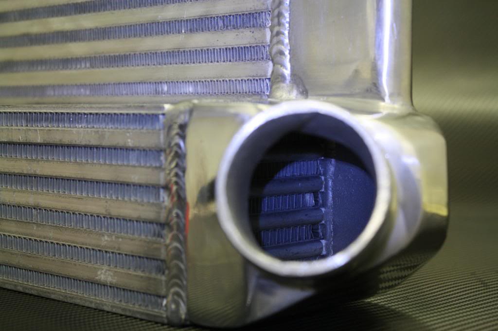

Allow me:
The Forge, with welded sheet metal end tanks (poor flow), protuberant tubes.
and the Helix, with cast end tanks, much greater fin density, thicker core, and bull-nosed bars inside the end tanks.
These differences may seem like details, but they are what makes ours perform. We have reams of test data, collected with our proprietary test equipment including flir imaging and independent-from-OBD2 sensors.
