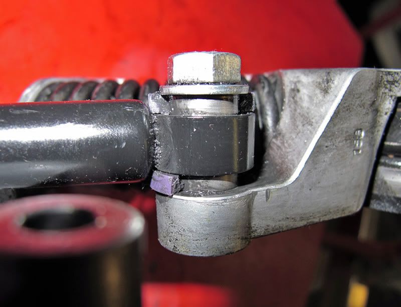

Here are mine after 12,000 miles.
The bushings were installed on a brand new tensioner assembly.
We figured the bushings are actually too stiff, causing early failure of the damper. Then when the damper goes, it pounds at the bushings until they fall apart. Just a theory.........
Jim

Originally Posted by jimz68 View Post
Well.......
Jim
Those are the Powerflex bushings?
Yep.
Jim
Well.......
Jim
You should send this to Powerflexusa, they would be interested in seeing this. Either it's a failure in the bushing, or the shock is bad and ruined the bushing.
Well.......
Jim
Just under my car today and happened to see that my bushings are in the same shape as yours were in this pic, installed less than a year ago.

I went ahead and pulled the damper tonight and took some pics, almost like the provided lube turned to glue. Damper seems to be functioning fine, I'll compare to the new damper when I get it next week:

Originally Posted by ericfreeman View Post
Damn! Looks like I may have wasted $40 on the Powerflex bushings for my '04S. Thought this would be a wise upgrade (haven't installed the bushings yet) but based on these experiences I'm now thinking otherwise. Will be interested to follow this thread....
Eric
Take a look here.
https://www.northamericanmotoring.co...orary-fix.html
Powerflex had a bad batch of the raw material, causing the part to "set up" incorrectly.

The response I received from PowerFlex USA indicates these bushings have a lifetime warranty that needs to be addressed at/with the place of purchase. I am going to give that a try and see if the new ones last longer than these.

Yes Bill you got those right about the time they had the bad batch, I've got replacements for you no problem. It's more than likely they came from that batch.

I picked up and installed the new set from Way today. Before installing I could tell the bushings felt different from what I remember of the original ones, I believe I definitely had some of the bad batch.
