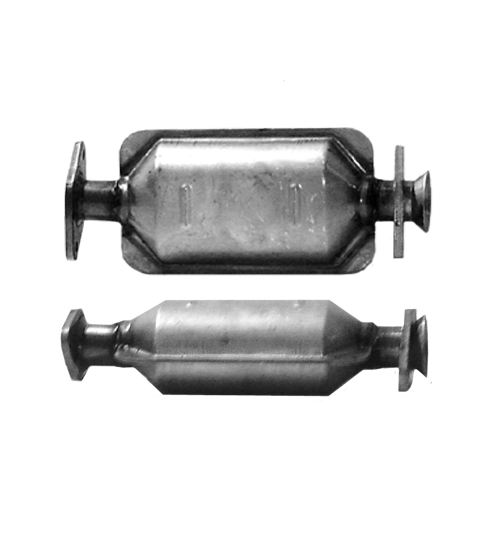

I am buying a 2004 MCS next week and have been wondering about this low cost header/cat combo:
This Megan Racing Header (AutoX is selling for $179+shipping)
and this Hoffman Sports Cat (on ebay for $274+shipping)
Hoffman Sports Cat
I Know next to nothing about these products (or minis in general) so any and all thoughts are welcome!

That catalytic converter is for a classic Mini and would not fit at all Arek.
I got a magnaflow cat, 2 flanges and made it work(https://www.northamericanmotoring.co...rt-header.html).
