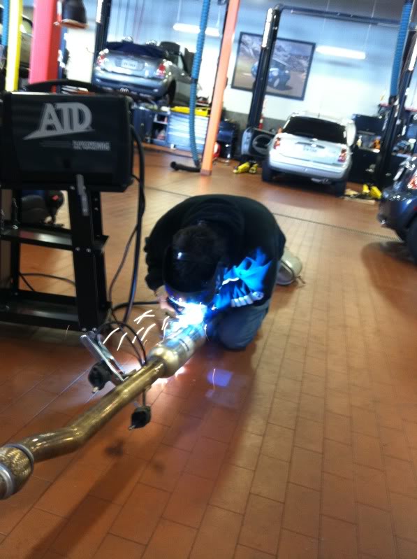

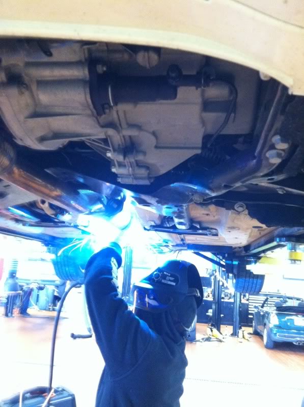

I did a custom magnaflow on mine which was far cheaper.
