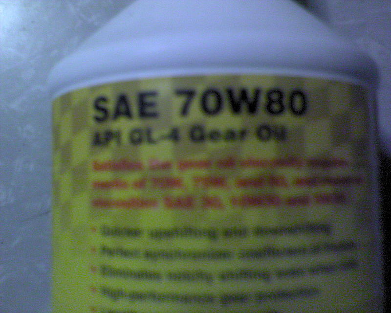

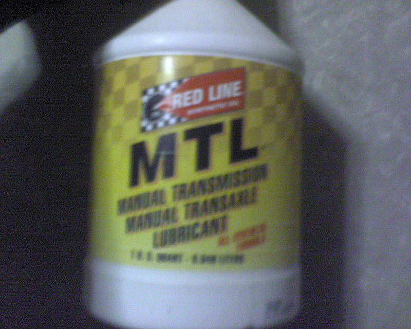

Old Feb 16, 2008 | 05:19 PM
hemiheaded18's Avatar
hemiheaded18
Joined: Nov 2006
Posts: 3,673
Originally Posted by UKSUV
If it had 75-80 or something like that...You have the gear oil and not MTL...
You want to try to prove me wrong again?
