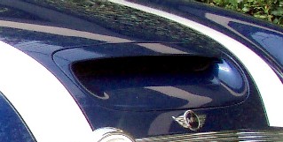

Ive seen this pics but I dont know which is the ram air intake, If I change the hood scoop Ill like to get the smaller one, I dont want my car to look too agressive.

The one on the left is Ram, the one on the right is Extreme

Im looking for something which looks like the first pic, If the ram intake looks like the second one, Ill probably get the air diverter. I want to keep my OEM appearance.
Is yours the Ram or the Extreme?
Attached Thumbnails M7 ram air intake or Alta intercooler air diverter-r-017.jpg   M7 ram air intake or Alta intercooler air diverter-101015962_1ac8824543.jpg

Mine is the Ram scoop (same as the second picture). See here for more photos. I wouldn't fret it much in terms of not being OEM. What's the point of modding your car if you want it to completely look OEM? It's a good looks/performance mod for low cost. That's just my 2c

Actually that photo is informative in a number of ways. It's an M7 Ram, with the stock IC diverter. You can see how much of the incoming air is "wasted" against the front of the diverter. That's why you need the Alta, but it must be modified, or you can fab-up your own diverter. It's just metalwork 101, not too hard.
