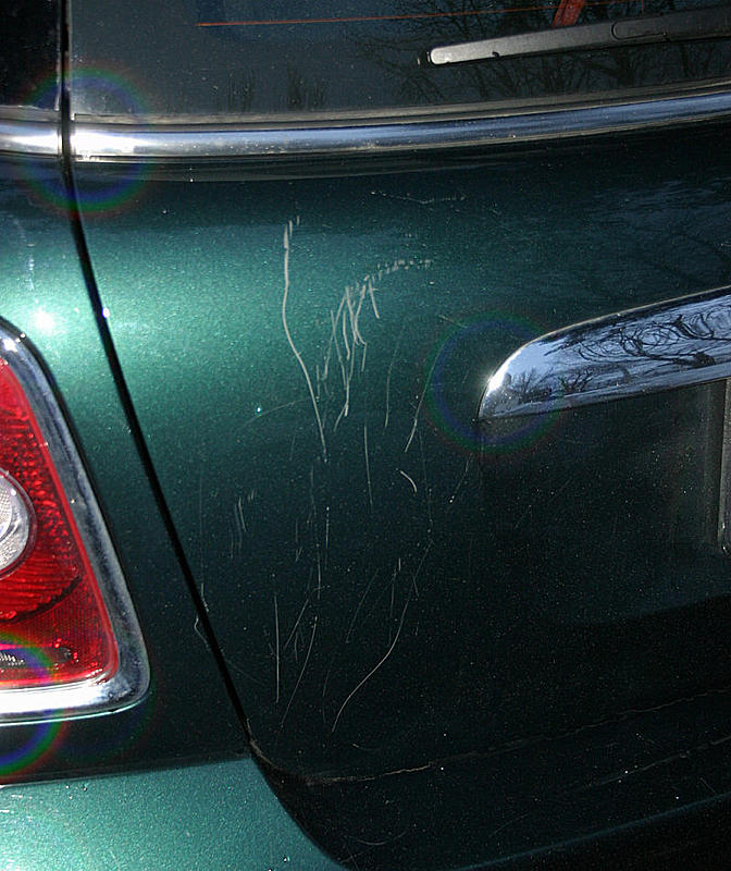

OK, as promised, here a couple of pics of the damage (and another of my MINI just for fun). The pics are kinda crappy because I was running out of daylight and in a hurry but hopefully you get the idea.

If it were my car I would get some 1500 grit sand paper and wet sand the scratches. Then buy some of this:
3M™ Finesse-It™ II Finishing Material
Designed for use on O.E.M. and fully cured automotive paints, can remove grade 1500 sand scratches and removes swirl marks after compounding, while leaving a glazed finish.
Follow the directions on the bottle and see what you end up with. The worst that can happen is that you will be out around $25 and discover that your scratches are too deep to repair without taking your car to a body shop. The best that can happen is that you can make the car look brand new again. And what will probably happen is somewhere in between. But maybe it will get out the vast majority of the scratches and you can live with the rest.

Although I'm currently view this thread on my QVGA phone the scrapes remind me of dog claw scratches and those can be improved. In fact i did just that on a BRG MINI as yours and that was only using a buffer. If the scrapers were wood try claying the spots first. That will remove any wood fiber transfer in the scratches.

I'm sorry but this is very bad advice to give to someone that has never wetsanded. He has another option you haven't even considered. A professional with wet sanding experience might be able to improve the paint, but in the wrong hands all it takes is one stroke too many to ruin any potential for success. Further if the scratches are only through the clear, it's possible that the cost of the repair could be minimized if the base hasn't been penetrated. In experienced hands, you know when to stop once you've broken through the clear. And I certainly wouldn't start with 1500 grit for a beginner. If you're going to learn on your own paint, start with 2500 or 3000 grit on a sanding block and expect to make no more than 10 superlight strokes along the scratches.Use bad sanding techniques and you might leave permanent sanding marks that can look as bad as the original scratches.

i think i got glass in my eyes right now looking at those picts.

Actually, I'd probably prefer to take it to a pro since the time and patience to do it right are what I'm short on at the moment. Nevertheless, this is exactly the kind of advice I need to know what kind of pro to look for and what questions to ask. Some of these things I didn't even know were possible and so I had nothing to respond with when the body shop guy said to repaint the whole thing.

looking at those picts, i think if you want to fully repair the paint you will
have to repaint it.
looks like it's down to the primer.

Now that I'm looking at this on my large monitor, I still can't see how deep they are. Look at these scratches on this BRG MINI I did awhile back. They are similar, and they were fixed.

And I think your last comment is spot on. It IS hard to tell the extent of the damage unless you are looking at the car in person. If we were standing next to the car together it would probably be easier for us to discuss options and decide what course of action might be best.
