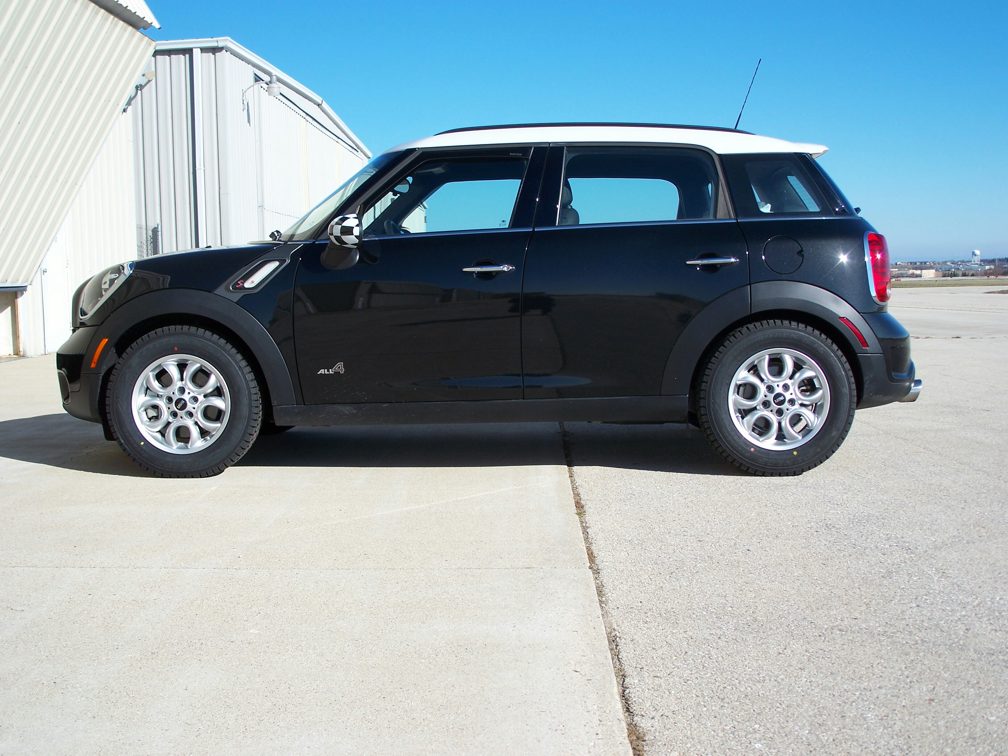

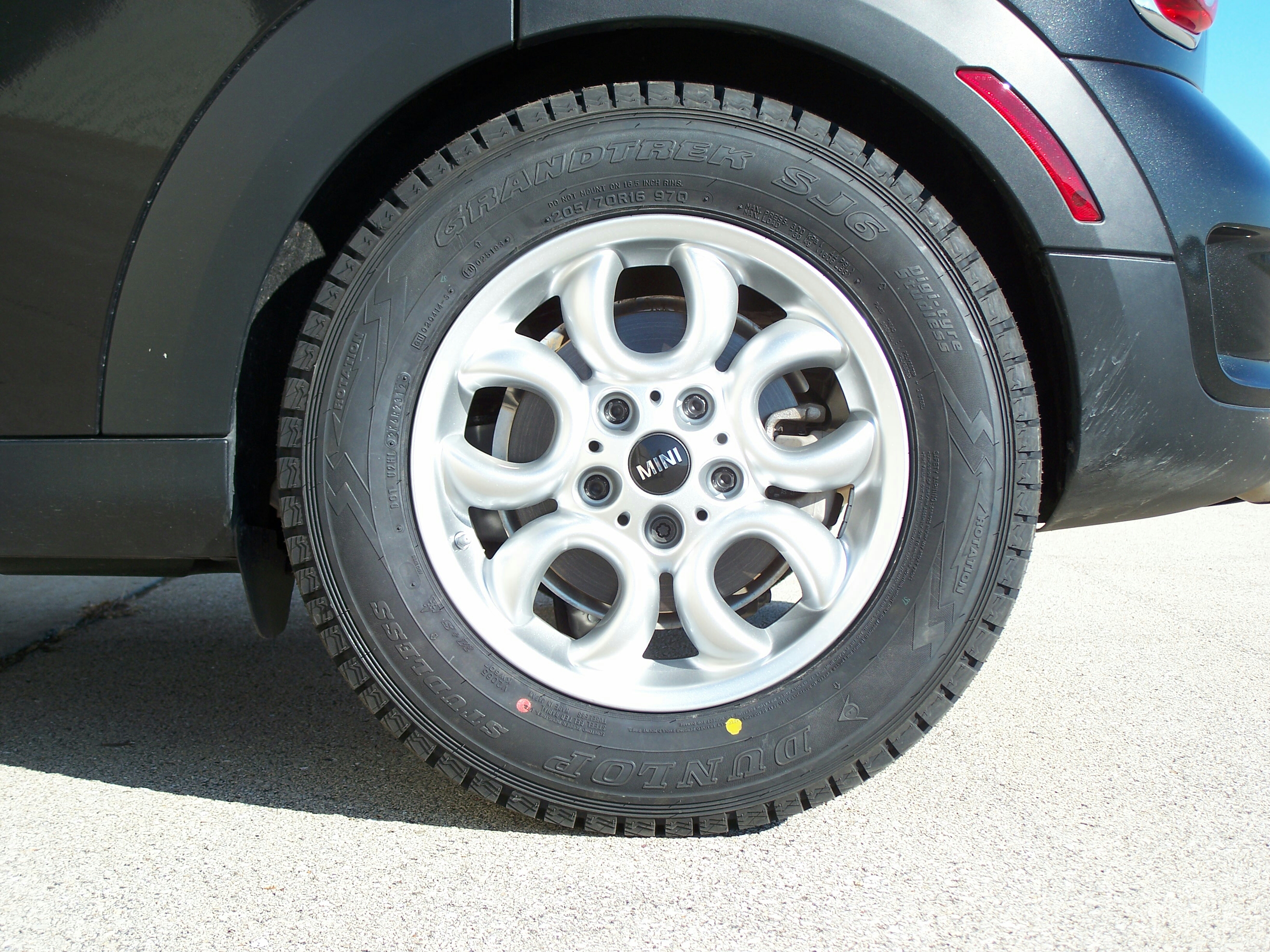

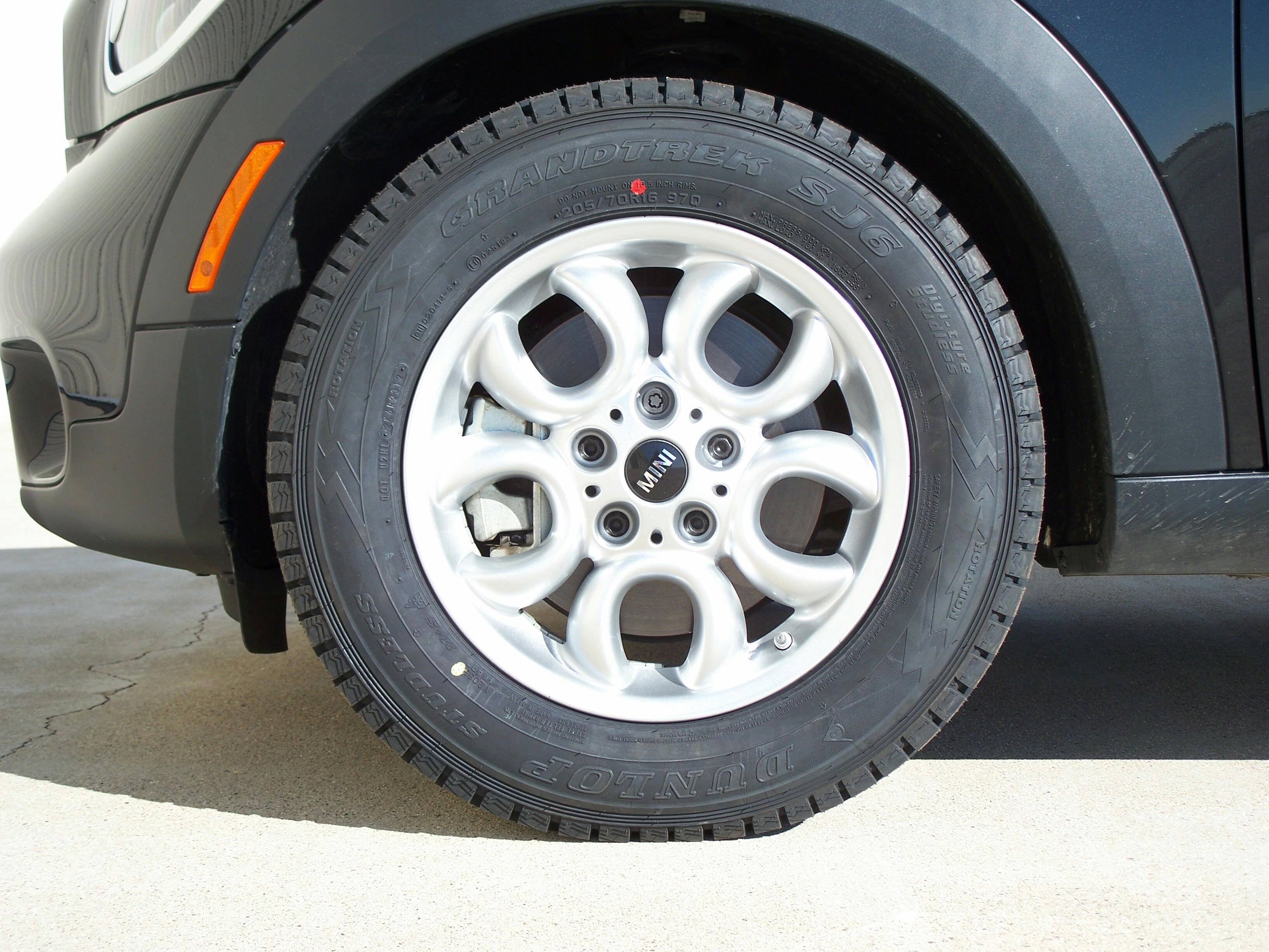

i am running mini oem euro 16 inch alloys on my 12 all4 ... 16 x 6.5 et 46, purchased from ecstuning ... they also have mini oem steelies in the same size
i run 205/70R16 winter tires on them that are 27.3 inch OD
for summer i run 225/50R18 (26.9 OD) vs the oem size 225/45R18 (25.9 OD)
215/75R16 will not fit on my car, but i have the factory sport suspension that id 10 mm lower than the standard suspension
215/70R16 do fit
Attached Thumbnails Small rims,fat tires-100_1920.jpg   Small rims,fat tires-100_1918.jpg   Small rims,fat tires-100_1922.jpg

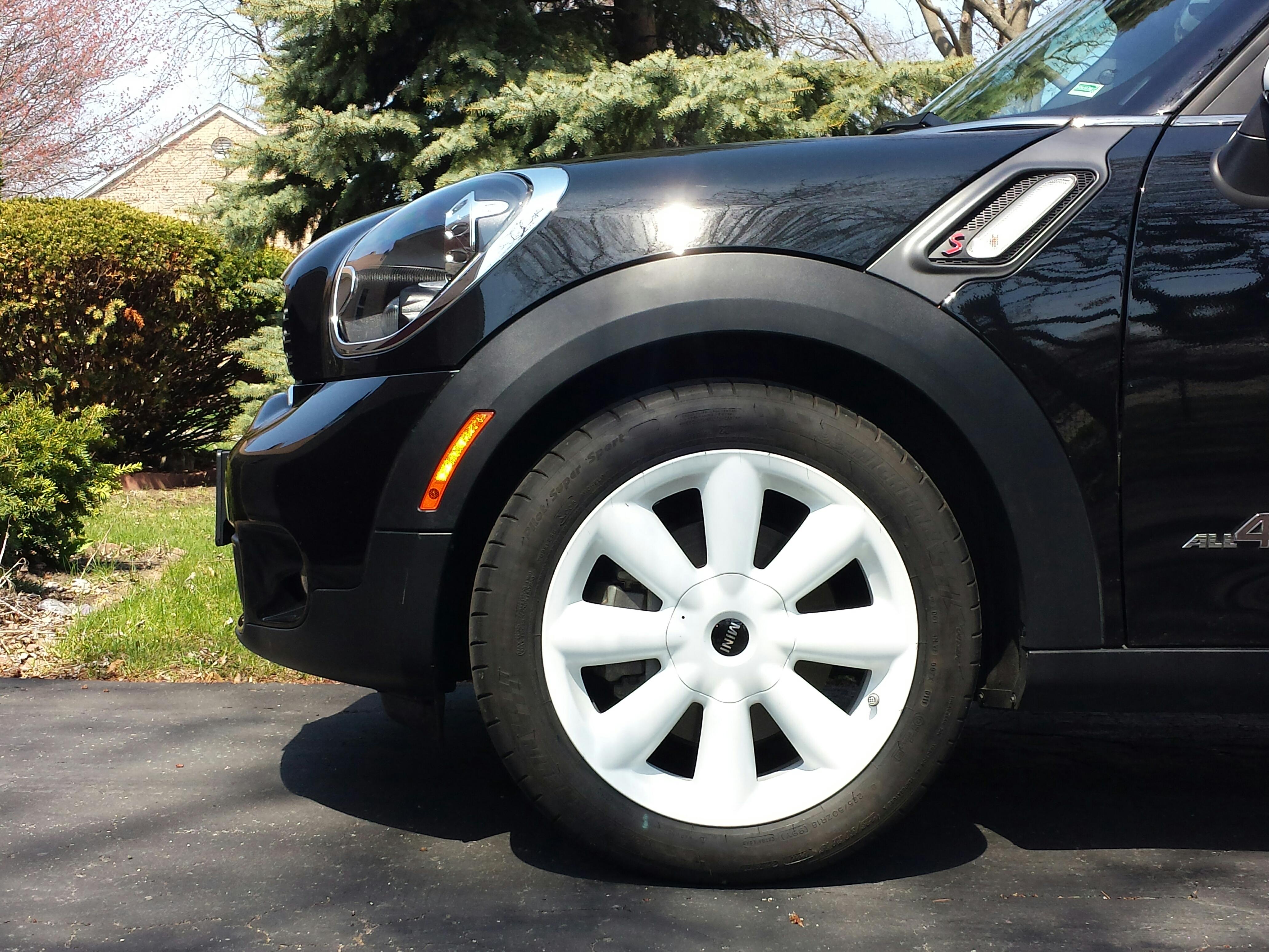

225/50R18s on oem 18x7.5 et 52 wheels
Attached Thumbnails Small rims,fat tires-2014-12-02-19.54.12.jpg   Small rims,fat tires-1401006898378.jpg   Small rims,fat tires-1401006919145.jpg   Small rims,fat tires-20140420_132130.jpg

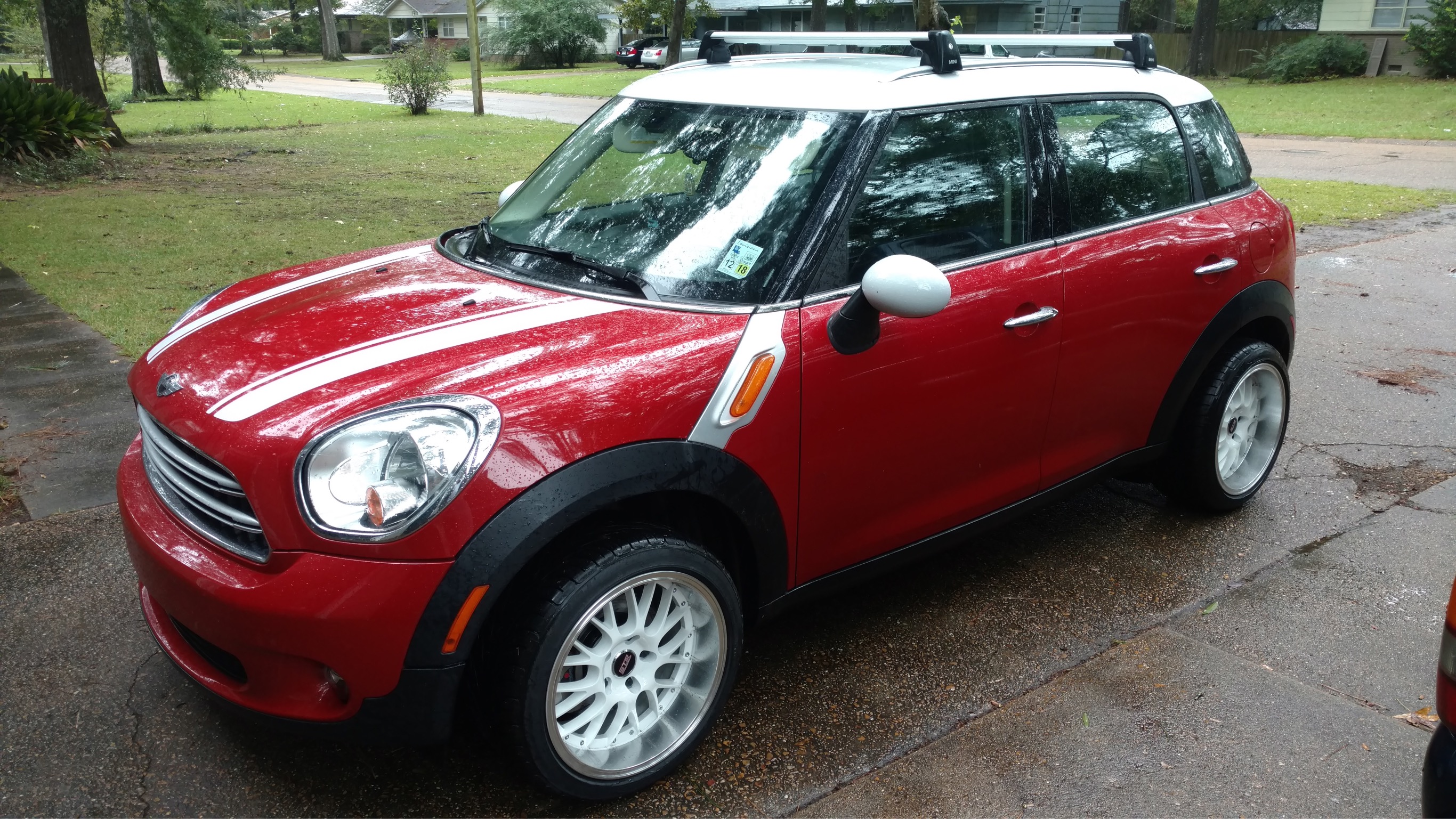

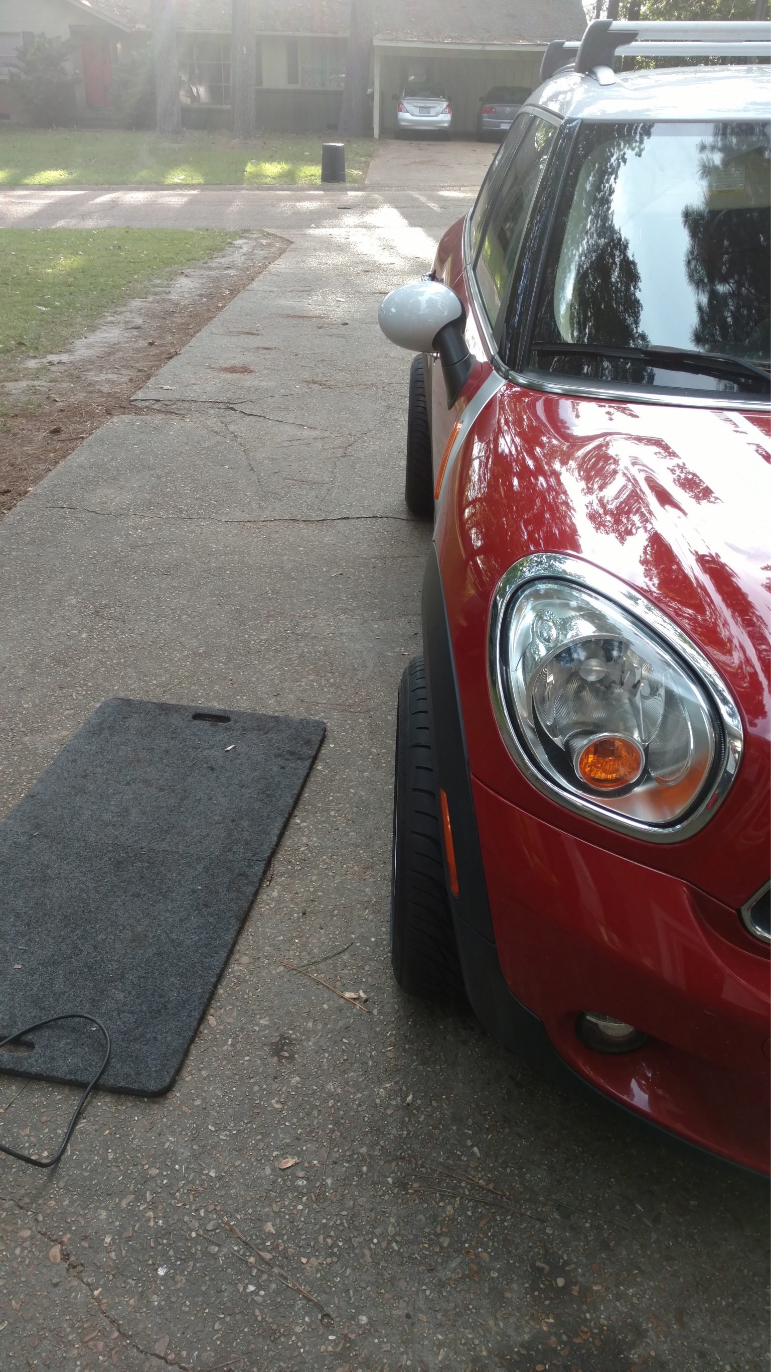

2016 countryman 17x9+20 offset 235/40r17
Ok, so I started to write this big long novel explanation, but it's to much information to write in one shot. If you have questions, let me know.
Attached Thumbnails Small rims,fat tires-img_0071.jpg   Small rims,fat tires-img_0072.jpg   Small rims,fat tires-img_0076.jpg   Small rims,fat tires-img_0078.jpg   Small rims,fat tires-img_0077.jpg
