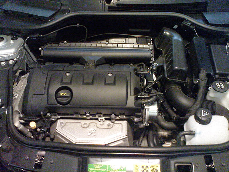

It think that my oem filter and intake-hose from the filter to the engine looks different than the us-minis.
But it would have been nice if the ddmworks-intake would fit...
And Merry Christmas
yeah it does look different from mine, what year is yours? mine is a 09. might want to wait on it till they actually can say if it can be done or not. or if pics are put up to show it just out of the box and not installed to get a better idea if you can do it or not.
Mine is a 2009 too. But my Mini is Swedish

Ok yeah it is a lot different then mine is wider.... i would honestly tell you to just order a custom one or a universal one. all mine is universal tubing and a cone filter.

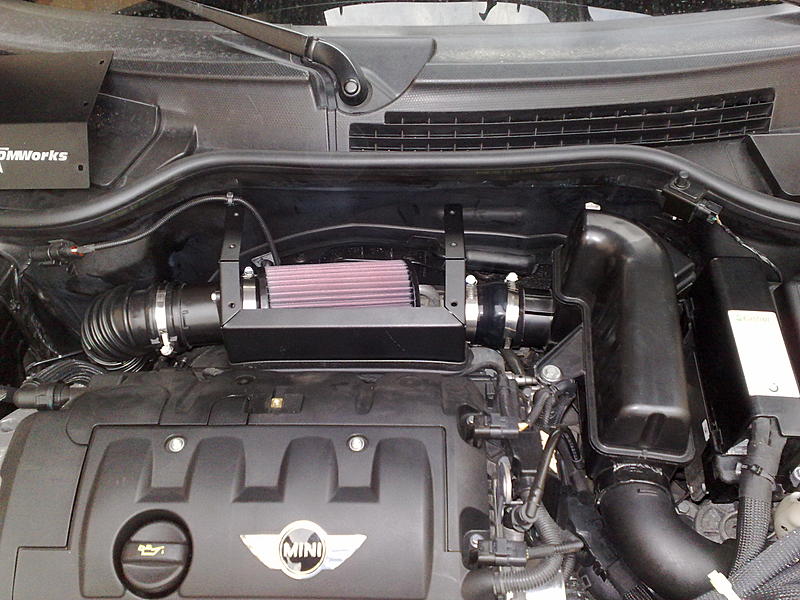

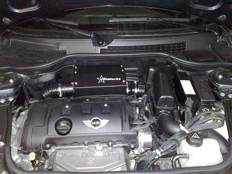

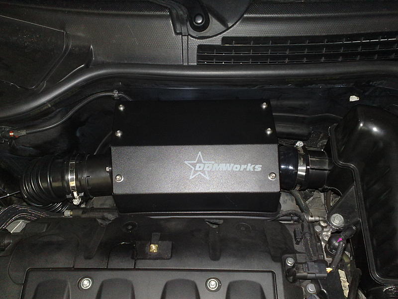

I hope to make happy someone with this post!!! I mounted DDM WORKS intake on my euro (Italy) Cooper without MAF.
All you need are:
- DDM WORKS intake (obvious!!)
- part number: 13717524713 http://www.realoem.com/bmw/showparts...00&hg=13&fg=20 (number 10 on drawing). USA intake pipe.
- part number: 13710429383 http://www.realoem.com/bmw/showparts...51&hg=11&fg=95 (number 9 on drawing). This part will replace the MAF sensor.
these parts are all you need to mount your DDM intake on euro version!!!
