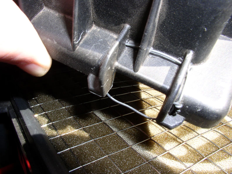

I replaced my air filter and found both tabs missing. Rather than go 200+ miles to the dealer I fixed it myself: You can drill 2 tiny holes on either side of where the tabs used to be (very close to the body of the box, but not through the side of the box). Then, fashion a square shaped loop of wire, twisting the ends of the wire together. These will hook onto the bottom part of the box. The first time I did it, I had the wire loops to small/tight and the box wouldn't close. I cut the wires off and did it over (a little looser) and it it fits perfectly. You need stiff wire that will hold it's shape; I used electric fence wire. You can't even really see the fix when it's put back together, and the top fastens/unfastens the way it did before the tabs broke off.

OK, I took a picture of one of the wire loops I made. I actually drilled 5 tiny holes for each loop. To the right you can see the wire twisted together. The wire loops fit under the tabs on the lower part of the box, then just put the screws in on the right side of the box like you normally would. If you have the wires the right length, the lid will fit tight like it should. If the picture doesn't show up, look in my gallery; it's in there. I drilled the top 3 holes at one time. A long drill bit makes it easier.
Very cool. Thanks! I wonder if nylon zip-tie would also work. Will try it out.

A nylon zip tie might require holes too large. As you can see, I drilled as far away from the edges as possible for strength. I did this almost a year ago and it has held up fine.
