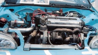

Posts: 43
built this over 10yrs ago - first twin turbo B16A CRX street car. Made over 450whp, ran 11.1 ET at 127 MPH at Pomona in 1998.
You my wise friend have no clue what your talking about...
tough being a "NOOB"
