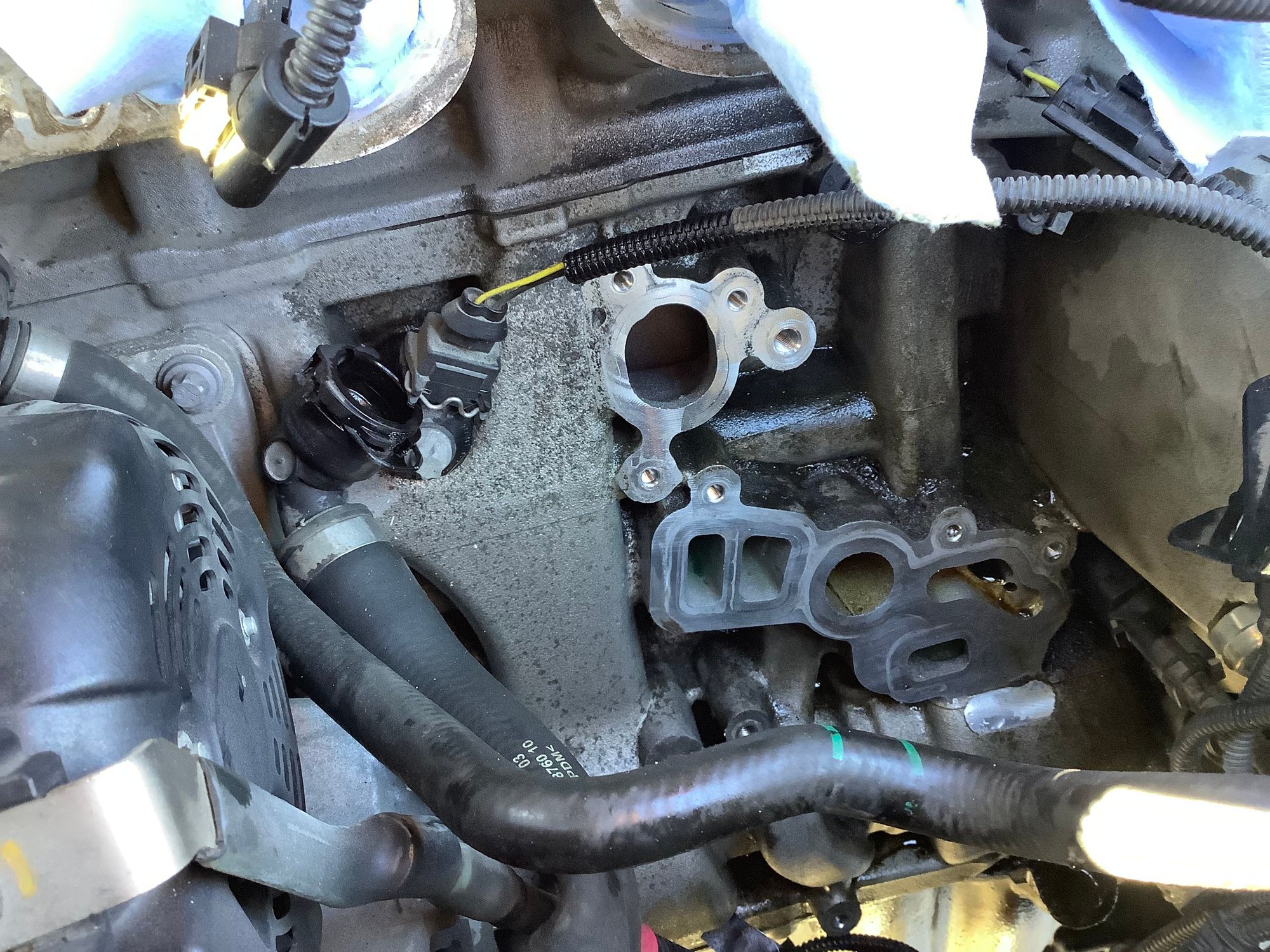

This is what it looked like once everything cleared out of the way.
Removed, couple of hard to reach bolts, but no AC line issues.

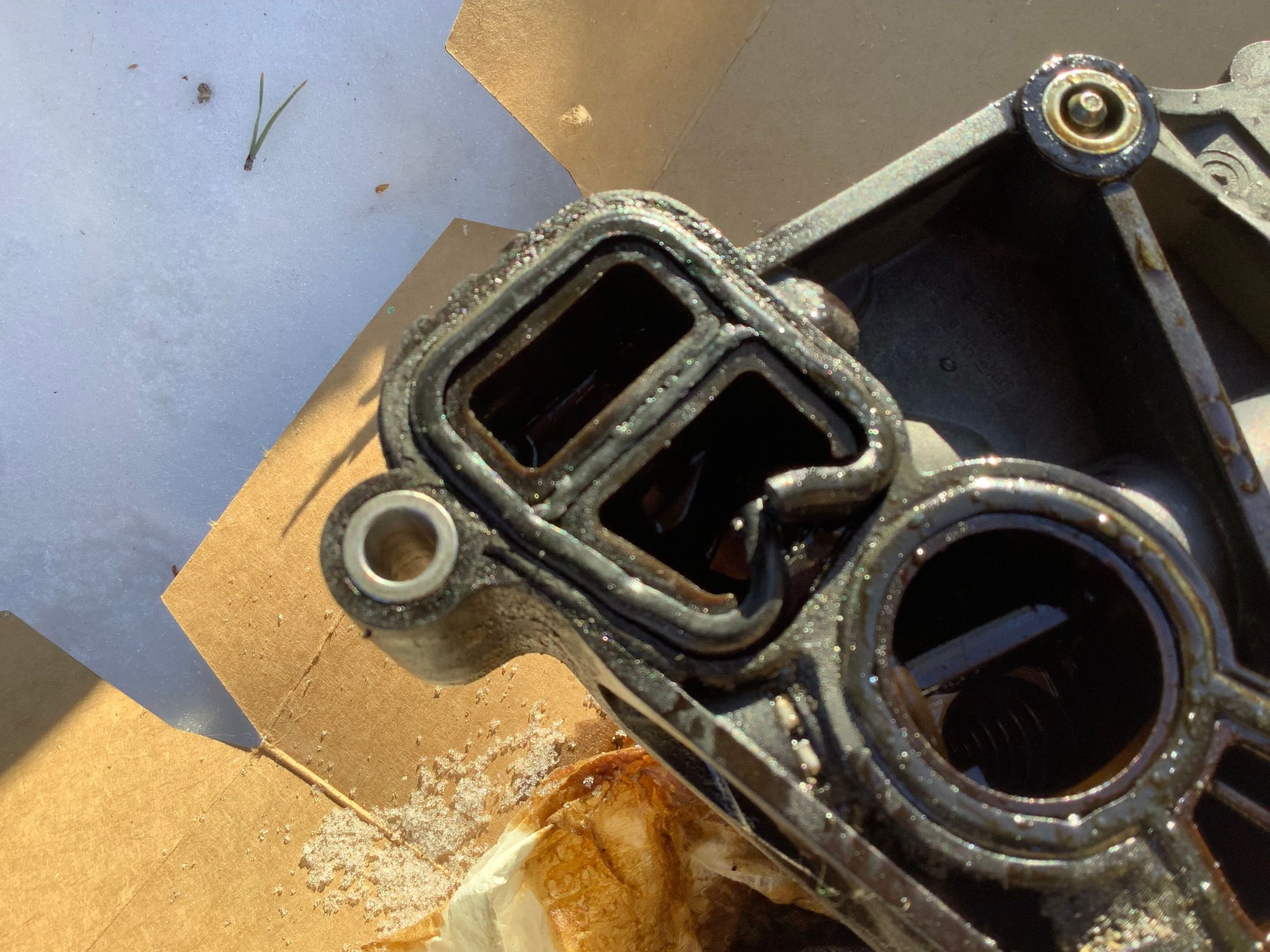

Looks like same failure as everyone else!

I removed the intake manifold as planned, I think there is more room and visibility compared to radiator shroud, etc. It went ok, struggled with the BMW electrical connections in the cold (was doing outside, still snow on the ground). When I got to the oil filter housing, it didn’t appear that the AC line on the compressor would be in the way, and it wasn’t! That was my biggest fear. Struggled with a couple of bolts (2 & 3), #2 seemed better from below, #3 just had a lot of wiring in the way, lots.
The housing came out the top of the engine compartment without any issue.
I replaced with a non-standard aluminum housing, and also replaced the coolant pipe above it with an aluminum part also. Torquing the bolts tonight, will double check in the morning and put everything back together.
