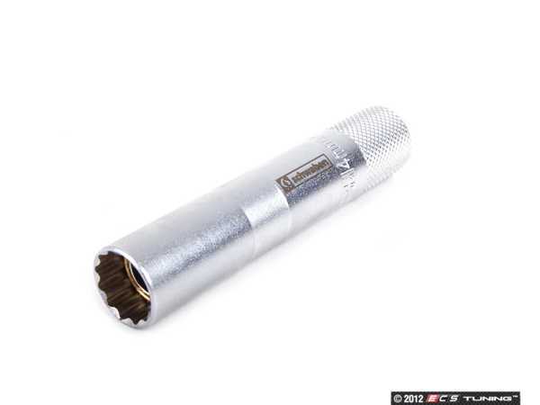

Pretty much the same as the F56-F60 Spark plug change DIY. The coil packs on the top have a little bolt. Different design then the gen 2 MINI
https://www.northamericanmotoring.co...ark-plugs.html
Here is the tool
https://www.ecstuning.com/b-schwaben.../001247sch01a/
