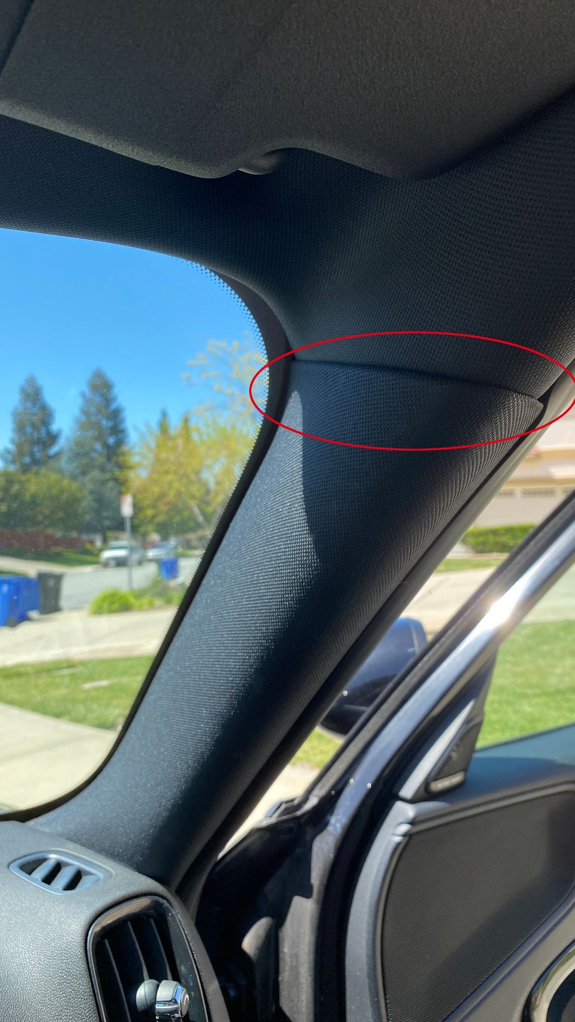

I'm finally getting around to installing front and rear dash cams in my 2018 F60. For the rear camera wiring, it would seem that I can route the wire across the headliner to the right A-Pillar and my first question is:
  • If I take the wire across the right-side A-Pillar and hide it behind and under the joint at the place indicated in the photo below, will that interfere with an air bag? When I look at the parts in realoem.com, it appears that there is no air bag that goes down the A-Pillar in the 2018 F60 – see the attached diagram.

Right-side A-Pillar (2018 F60) – I want to pass a wire at this connection point in the trim.

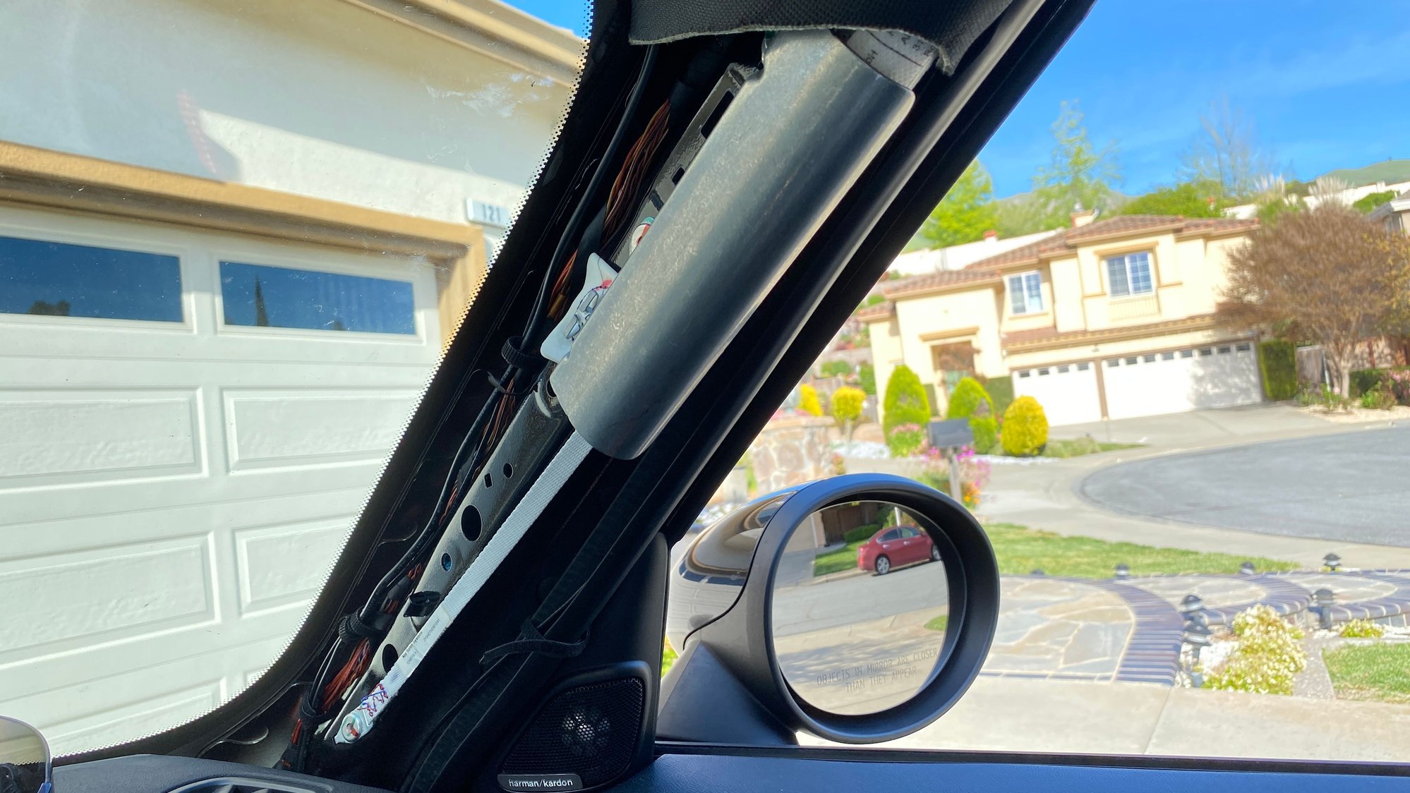

Well, I answered my own question about the A-Pillar by taking the trim off. The airbag does indeed “descend” farther into the pillar than is indicated in many diagrams, including ones from Mini that I found online. So, contrary to what a few YouTubers have shown when installing a dashcam in a Mini, the added wires need to be run down to the bottom of the A-pillar on the windshield side, not across the top of the A-pillar trim. I tethered two wires to the harness at the windshield side, visible in the attached photo. Hope this is helpful to anyone else planning to do their own dashcam installation that includes a rear camera.
-Bob
