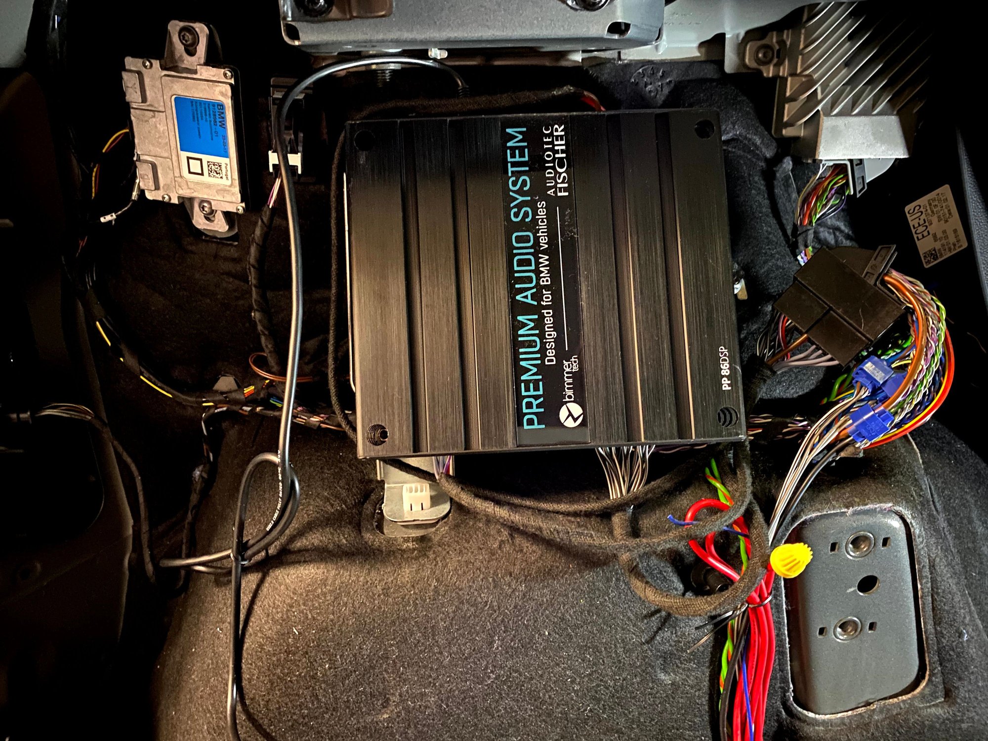

So far on my '17 All4 S:
  • Retrofit folding side mirrors
  • Retrofit digital instrument cluster
  • Added full screen CarPlay
  • Upgraded to BimmerTech Amp
  • Added Dinan Sport Tuner
  • Added Yakima Railbar
  • Added K&N drop-in filter
  • Upgraded to illuminated shift ****
Upcoming:
  • Install Stealth Hitch
  • Replace Dinan Sport with ECU Flash Tune
  • Install Alpha One Speakers & Dynamat

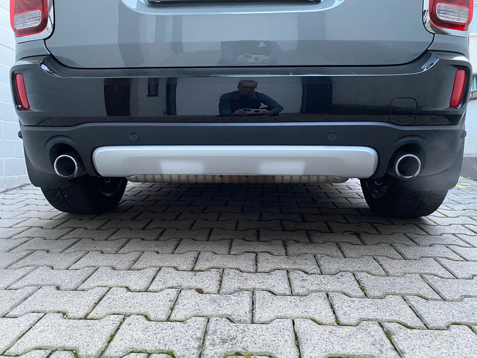

No coding for the install, but you do have to code the hatch kick sensor off before using it. You’ll see in the photo below, it looks no different than stock when you don’t have the tow or hitch connections attached. But when you do hook them up, you need to turn it off. I use Bimmercode to switch the two options to night_aktiv. It’s in the BDC module.
Without adapters attached.
Turn these off before attaching hitch/tow components.

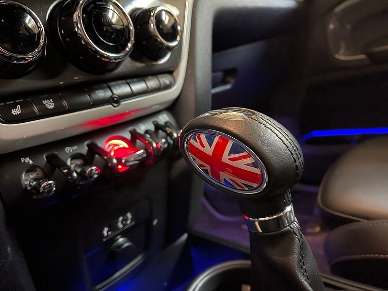

Just some Minor Mini Mods. Getting a few Union Jacks in place. I also got Bimmercode and turned off Auto Start/Stop and made my mirrors to fold upon the car being locked. I'm just starting with that app so I'll probably make some more changes as I learn more about it.
Just a little Union Jack
