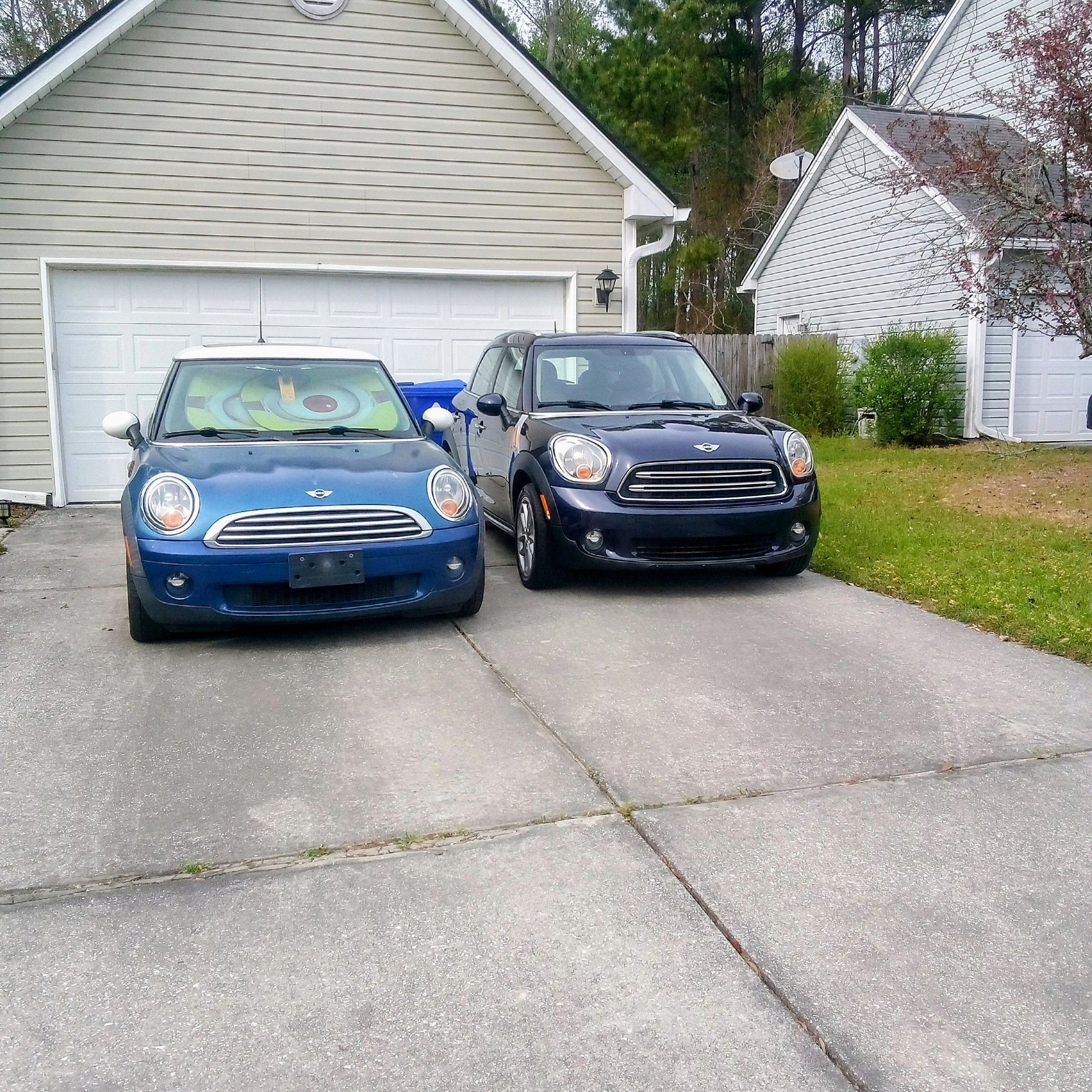

2015 N16, bought 2024, now at 96000.
Replaced:
Thermostat
Coolant Pipe
Front right axle
Water pump pulley
Side markers
New powerflex control arm bushings
Both wishbone brackets
Assorted badges and brake sensors
Going in for a new timing chain Tuesday - death rattle started this morning. Installing new front wheel bearings when she comes out of the shop.
