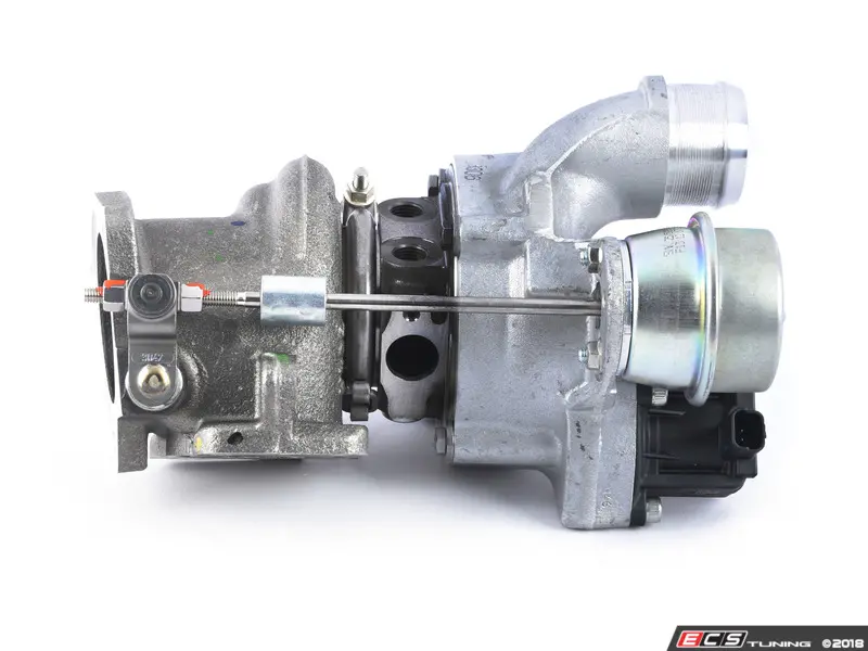

I can post a pic, appears to be leaking oil at the clamps between hot and intake side (looks charred/black). Dealer at last oil change said some oil in the charge pipe going to the intercooler. It spools, and makes boost but I dont know what to do next.

Current turbo state
Current pic, the black seems like sootish
Old Jun 20, 2025 | 06:33 AM
Posts: 36,762
Likes: 2,551
Yea, looks like that main clamp that's not available from MINI on its own. I worry if you tighten that clamp a hair it might bust it. Also you will have a little oil going into the intercooler. Its like a light coating, same thing at the turbo inlet. Anymore then that and something is leaking into the turbo. Its hard to tell unless you dig into things and look.
