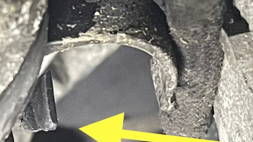

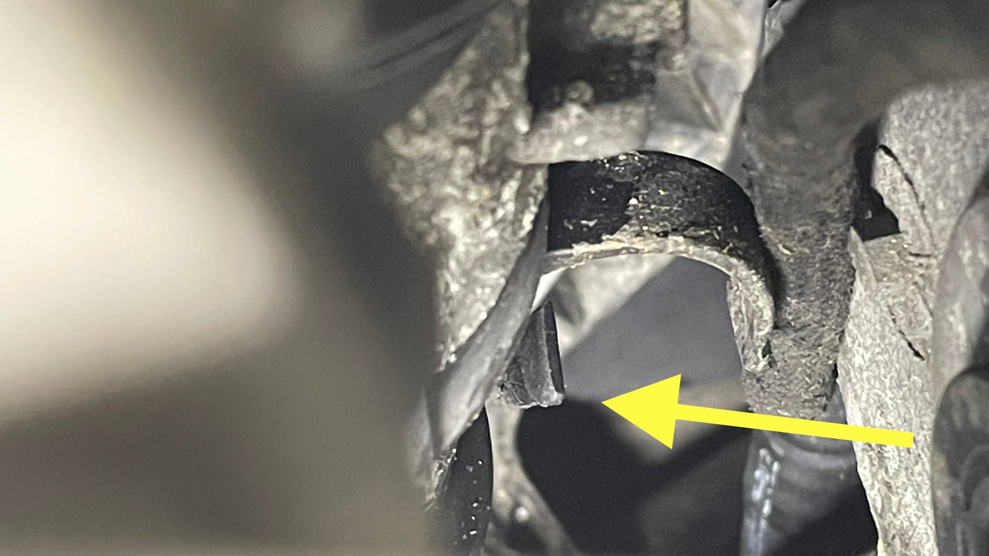

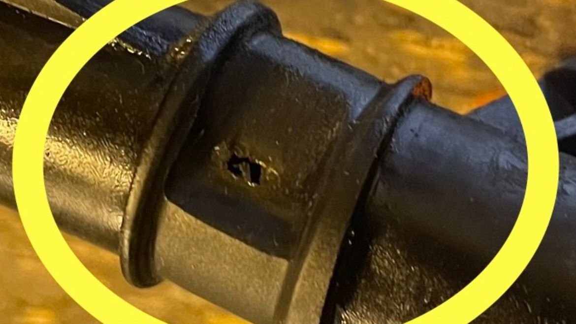

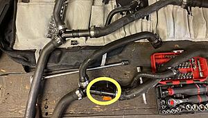

Overview, new pipe and original pipe. Fault area circled
Worn right through by the clip that was folded over
Edge of the clip that was folded over from the production line?

So I ordered the pipe (100€) and decided to have a look at it myself.
4 hours later the fault is found and pipe replaced.

The fault was the plastic clip that holds the Y-pipe to the inlet manifold/throttle body(?) it was doubled over on the inside edge, most likely this occurred when the car was built in the factory, and after 9 years of vibration, the edge of the folded over clip wore through the y-pipe.
You can see it in the video and pictures.
