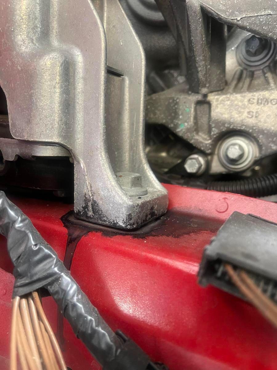

We just picked up my Wife's Mini and all good. Got a better explanation that the motor mounts are viscous/liquid filled rubber isolation chambers that sometimes rupture and loose the liquid. Kinda like a shock absorber it helps to further soften the vibration felt/transferred from the engine to the frame of the car. I did some Google and found this Engine Mount How It Works.... link that I thought was pretty good. So my wife's top engine mount has leaked some fluid but it still has the rubber there for vibration isolation it's just not working as well as a brand new mount. $129 for the part $160 to replace I said I'd wait as I'd like to see how hard it is to install one of these myself. After getting home and looking under the hood I see a cross/frame brace from the top of the shock tower frame to the back of the radiator cross brace/bracket that seems to be part of what the engine mount attaches to or is under. It looks tight and I'll start Google'ing and searching this forum for others whom have done this replacement. Kinda disappointing to have such a basic component fail on an 8 year old car with 32K miles on it that is NOT aggressively driven except by me occasionally!
A quick search on Amazon leads me to believe it's the
Top Right Motor Mount here for $51 Top Right Motor Mount here for $51
so depending on how hard this is to install I'll most likely be doing it....

We have a bunch on febi and vibracoustic ( aka genuine MINI) in stock Powerlex makes a insert now also which is linked, helps reduce the flex.

That's awesome and I'm interested in DIY.....have been looking for videos or instructions on how to install the Upper Engine Mount. I found one that mentions putting the car on jack stands, removing the wheel well liner on the passenger side, removing the lower wishbone mount and then using a jack to lift the engine to remove load from the upper mount. Open to any more guidance your or others can offer. I have a lift at my house so that make so many things easier....but removing the wheel well liner seems no bueno to me but I just started looking for solutions so if that's it I can handle it. We don't race or drive crazy so I'd say OEM motor mount is fine but if they fail after 32K miles I'd rather put something better in so it doesn't happen again. THANKS!

Thats the way i would do it, the jack helps as you can move the engine a little to angle it right to take the load off. Close to the R56 motor mount repair, Just more room in the engine bay. If i come across one for an R60/R61 specifically i will post up.
