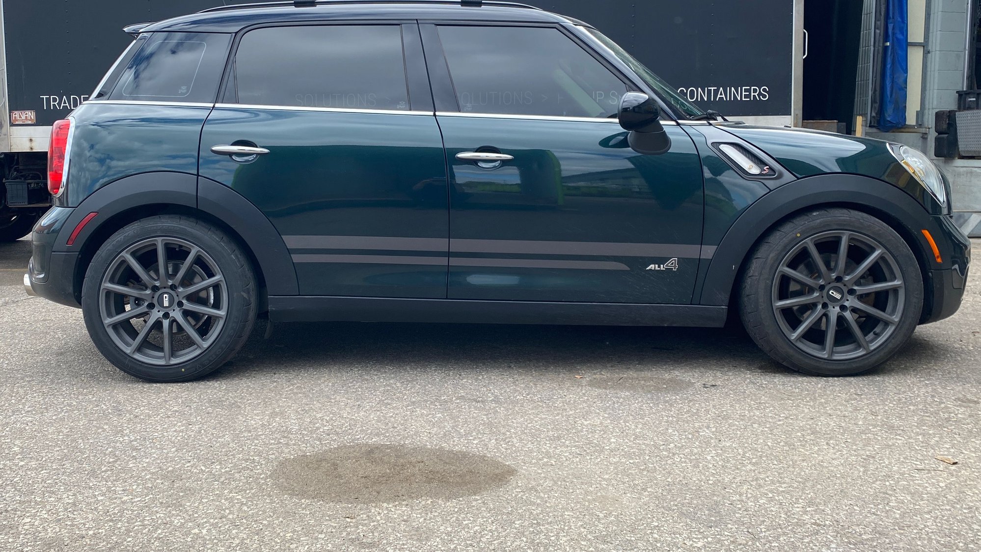

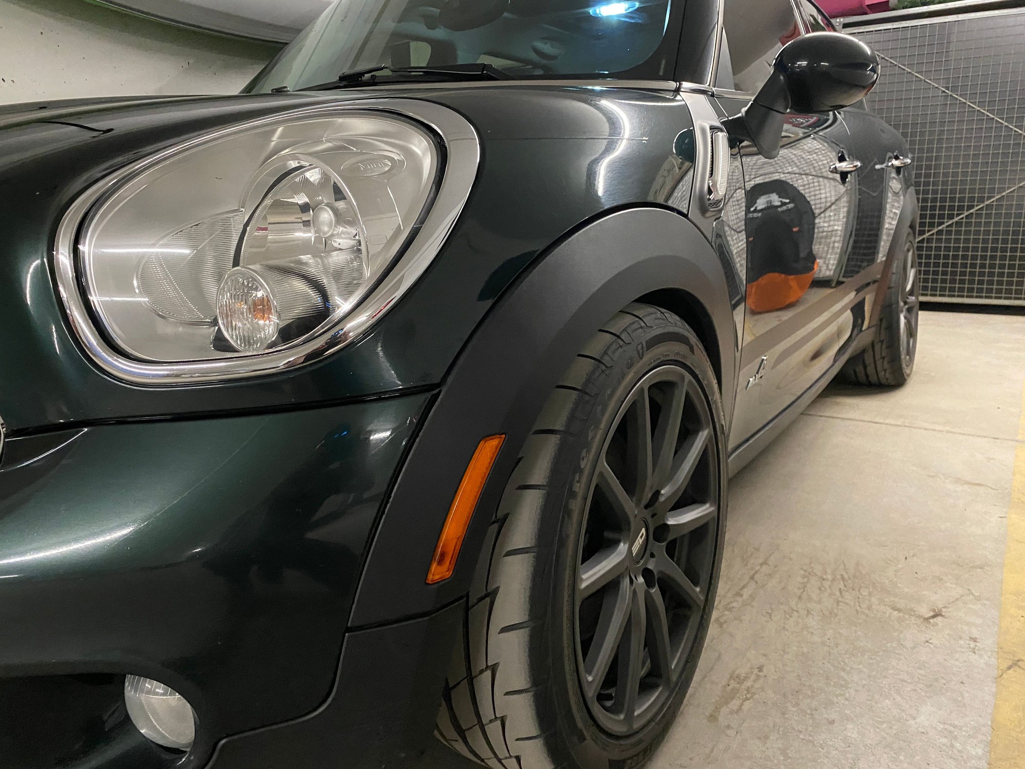

Not sure if this will help but here is what I have done to my 2013 R60 All4 S:
H&R lowering springs - 1.4" front, 1.4" Rear
Firestone Firehawk Indy 500 235/45R18
EURO DESIGN Wheels Legend Matte Gunmetal (18"x8", 35 Offset, 5x120 Bolt Pattern, 72.6mm Center Bore)
Seems to be just right - with no rubbing, BUT it is very close.
Tires are 12mm larger diameter than stock and offset is 15mm further out towards the fender.
Before and after photos to show the drop.
Before
Straight after
Night after
Night after
