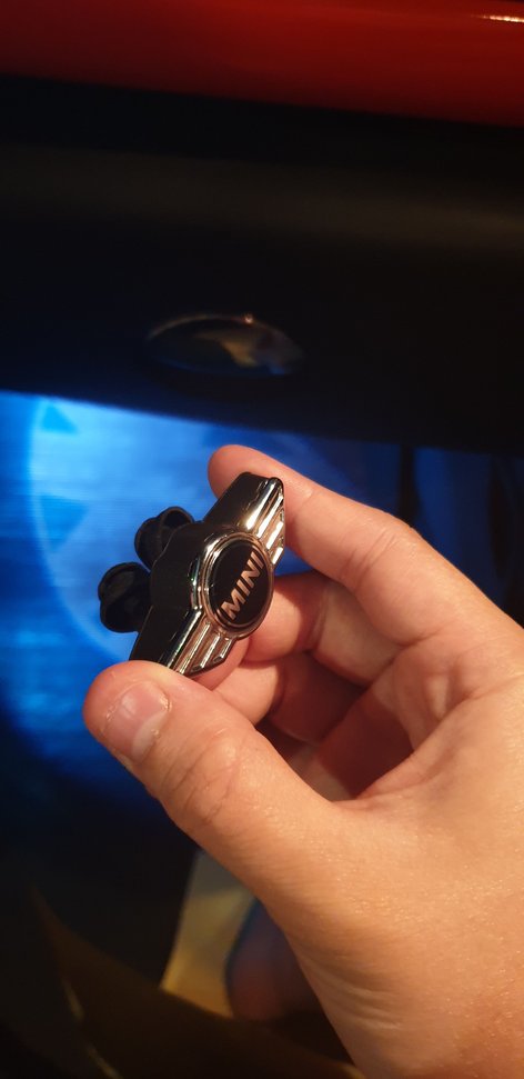

Thank you. For the AC perfume :
Well unfortunately i didn't know about the part number, but this little Mini vent perfume are available in the official Mini Dealer. It was 180.000 Rupiah (please convert to your currency from Rupiah). If this item is been sold in the Official Mini Dealer in my country then I am sure they will sell this item in the Official Mini Dealer in your country as Mini Dealer Standard, like other accessories.
